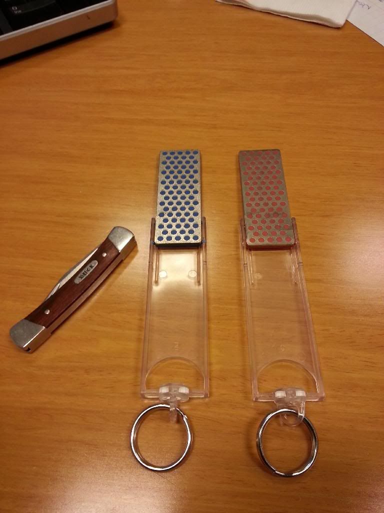

I will do that sir! The Mrs. and myself have been hibernating the past two days having off from work, I think she is feeling the need to do a little shopping. Will report back when the DMT sharpener comes in as well.

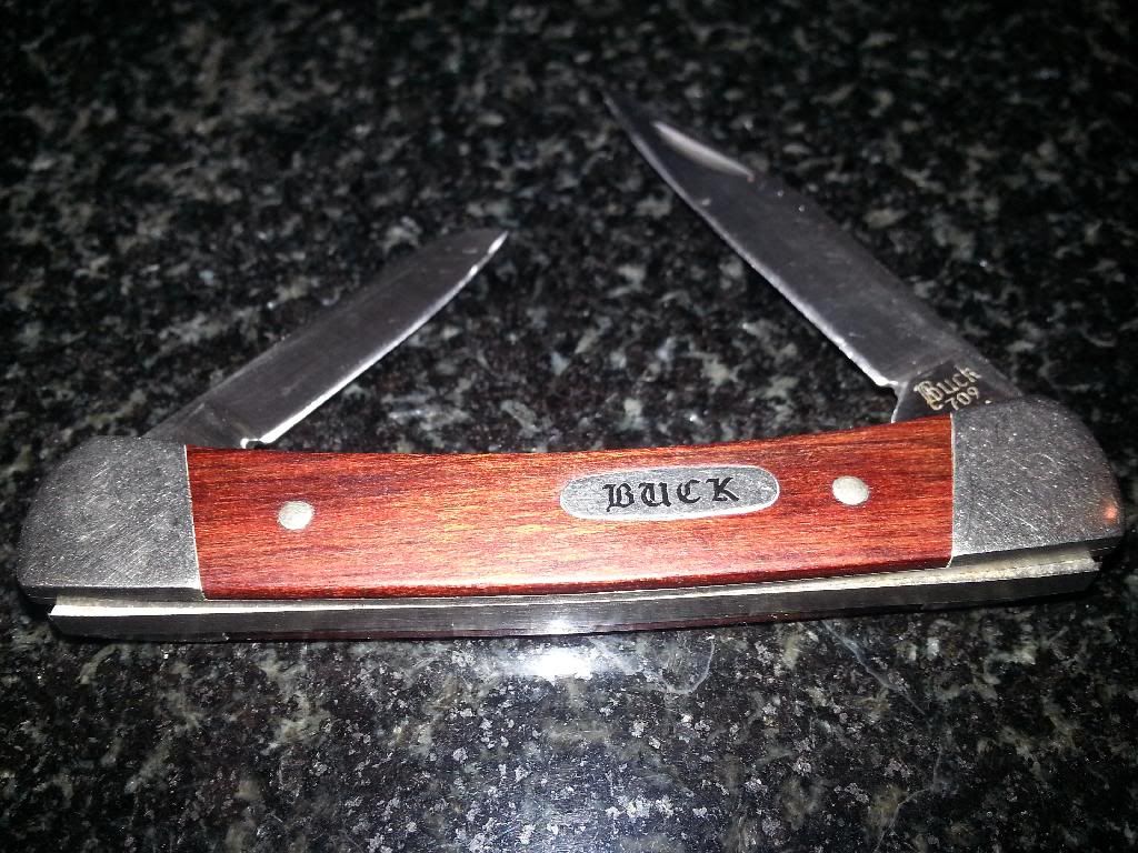

Obligatory photo of the little pen knife, I'm quite fond of this particular pattern! It looks like a Peanut size 110!
Nice 709 :)

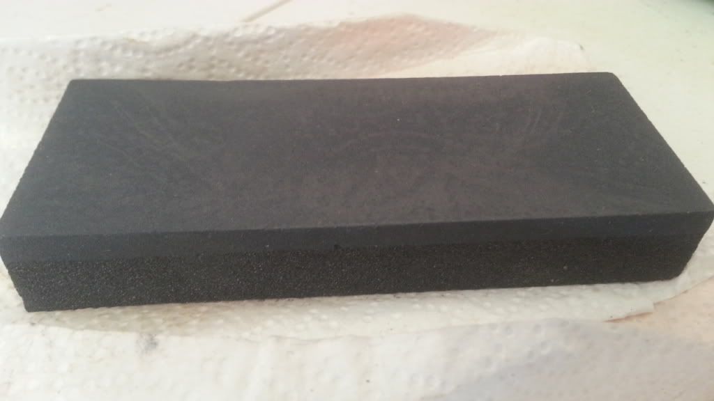

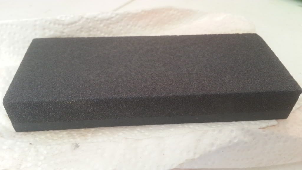

Here is my cheapo stone :)
and the cheapo ceramic stone
and my rescaled 709 from 1990 :) 425 steel with Amboyna Burl. I love these little 700 series. Perfect for going to town when dressed up.

The DMT did the trick! Sharpened the Buck quite fast actually. It still has a tooth edge. The fine hone gets it to 600 grit if I want it any smoother I'm going to have to a much higher grit as it's the only way to smooth out this old Buck 440C steel. The carbides are just huge! On other steels the 600 is enough for the steel to have that smooth non-toothy edge but that isn't the property of this old 440C.
I'm going to carry the Yearling as is with a 600 grit edge. Thanks for the help all!
