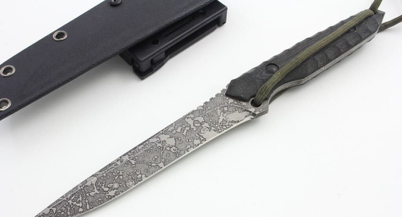

Can anyone confirm this is a genuine Kiku Matsuda?

This is my personal opinion, but this knife looks like a copy to me. In fact, if I have to be specific, I think it is a copy of the Raijin model. Here are my reasons.
Someone above has already said what needs to be said about the blade.
Kiku knives, as far as I can see, have a protruding finger notch at the top of the blade form for the thumb on the longer models.
The screws (pin\rivet) holding the handle are different on the kiku knives I have seen and looked at on the internet.
Also, the kydex sheaths generally follow a rectangular shape that includes the shape of the blade instead of taking the shape of the blade and ending.
As for my irrational reasons, for some reason this knife feels like a machine-made mass-produced knife rather than a handmade
one.
But they are biased. So an expert can enlighten us

Collecting for a long time is one thing, whether the knife is genuine or not is another. The seller of the knife said that the knife was made in USA in the photo you shared. Doesn't this indicate that there is at least a possibility that he does not have enough information about what he is buying in this particular knife? Also @KenHash made a very important point. "Every Kiku I've had has been hamaguriba (convex grind) and a clear edge bevel was not visible." But as I said, whatever we say, these are just speculations.

I'm no expert on Matsuda and I don't pretend to have anything other than an informed opinion in answer to this question. But Matsuda has produced knives that did not include the steel type printed on the blade. He has also made knives that possessed edge bevels and were not convex- or zero-ground. Here are two older examples that look to be from the same era as Dan512's knife.
Also, while I agree that it's a good idea for Dan512 to identify the model, I don't agree that the inability to do so weighs in favor of the knife's being a fake. I understand that an unidentifiable model might be easy to claim as a one-off. But doesn't that defeat the purpose of counterfeiting? You can pretend a couple of fakes are "one of a kind" models, but you certainly can't do that on a mass scale, which I think is what counterfeiters generally shoot for. All the maker has to do is announce "I never made a knife that looked like that" and the fake becomes worthless.
Dan512's knife came from the collection of a German knife maker and collector. It makes sense to me that he bought or traded for the knife directly from Kiku Matsuda at a knife show that they both attended.
-Steve
P.S. - A number stamped into the tang with a corresponding number etched into the scales is a common way for makers to marry up the correct handle scales to the blade after working on it (heat treating, acid etching, etc.).
The points raised above are exactly why I have not stated with absolute conviction that this subject knife is fake,
However, a model that can not be identified raises a red flag. And I have searched Google Japan rather vigorously.
I have also asked people I know who are more familiar with Kiku knives than I am, and have found no identification.
The suggestion that a "counterfeit" would not be made of a non-existing model is incorrect. Countefeiters in China have long made
copies of real makers with the models not corresponding to existing models.They simply copythe style and logo,A quick look ar Ebay at
Cold Steel and SOG knives will show this.
There are examples of Kiku knives that do not have the steel type. There are also examples that have no 菊 logo. For example, there are some that have
a bear's paw as a logo,. But these have been identified as having made by Kikuo Matsuda's son in the same shop.
So I look forward to either uncovering more clues, or getting a definitive response from Mr Matsuda himself at some point.

A lot of people don’t answer emails if identified as possible spam. He’s 70yo, maybe he doesn’t speak the language you emailed him in, maybe it’s trapped in a junk folder. He has a contact form on his website, try that.
His site says “One of his highly-regarded arts is called “Hamaguri-Ba“; This in an ancient Japanese art for Japanese sword.
A convex cross-section shape of blade, which has gently curve from the blade edge to the back, is called like that.”
Seems your edge isn’t like that. What language did you use, english may not be the best language to contact a 70yo Japanese Master Cutler.

One.other thing that has caught my eye is the handle..... I've only seen OD green and black canvas micarta scales on his work. Take it with a grain of salt though odds are he's used.all sorts of stuff but the two dominant ones are what I said above!!!
If you haven't done so already, I see that there are about 130 Kiku knives listed over at Arizona Custom Knives. Look at those and try to find a match, or at least matching features.
Kiku finally answered. As suspected, they were at the Blade show, hence the delay. But it was worth the wait:
