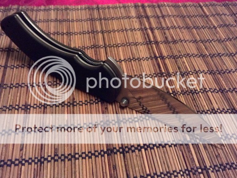

What about when using a buffing wheel on a bench grinder? I've polished some blades using a 6" buffing wheel with some compound and have gotten good results, but I am concerned that the blade does get quite hot, uncomfortable to the touch sometimes, and I dip it in some water then dry it off and make a few passes again. I'm not messing up the heat treat, am I?
I don't use a bench grinder/buffer, but it seems like you're handling it OK. Dipping the blade in water periodically is what I see frequently recommended here by the experts who do this often. I doubt you have anything to worry about, regarding overheating the blade. Especially if the blade is only 'uncomfortable to the touch'. To really mess up the heat treat of the blade as a whole, I think you have to go in excess of ~400F degrees with most steels. I'd think that would be a little beyond uncomfortable, if you got it that hot. ;)
The thin steel at the very cutting edge can obviously get very hot, very fast. But, if it's only that thin steel at the edge, that can be sharpened away fairly easily anyway. Sometimes even factory edges are somewhat 'soft' at the edge, likely from a little over-heating during the final buff/burr removal at the factory. The common 'fix' for that is to just re-sharpen the blade a couple or three times, and the edge works back into some healthy and harder steel.
Cool, thanks for the reassurance Dave. Here's what I did recently to my Rake after I removed the hump from the spine (also cooled the blade down often after every few passes on the grinder). It was a lot of fun, I might do this more often now that I know it's safe:
Pat special attention when you are anywhere near the tip.
At the tip, especially with power tools, you can burn the tip and the rest of the blade will only feel warm.
