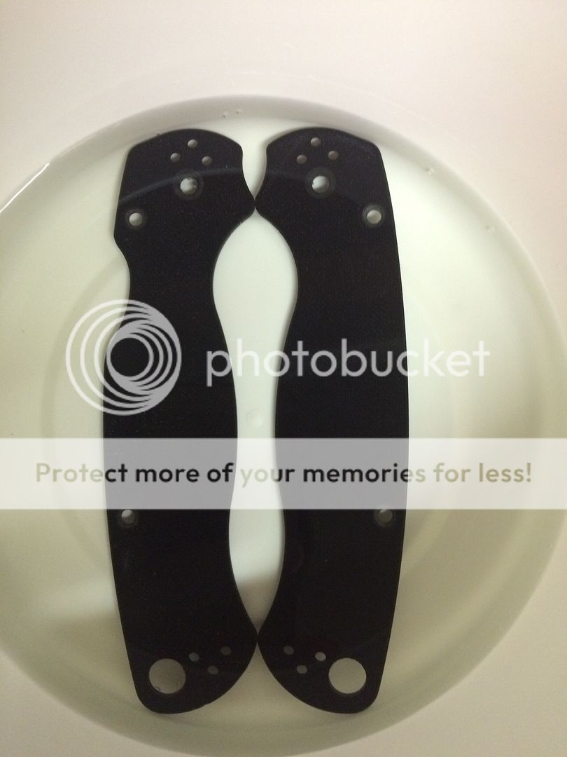

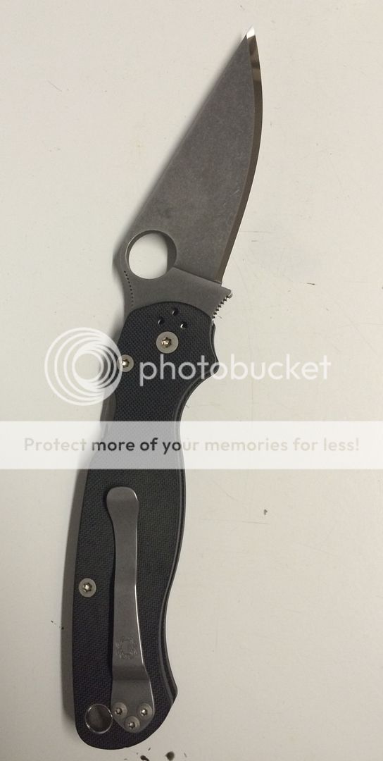

The answer is yes and no... i soaked the scales hoping to lighten/fade the original black color; soaked the scales in bleach for 24 hours and couldn't tell if the bleach did anything from looking at the scales in the bleach, scales still black and bleach is still the same color... pictures below.

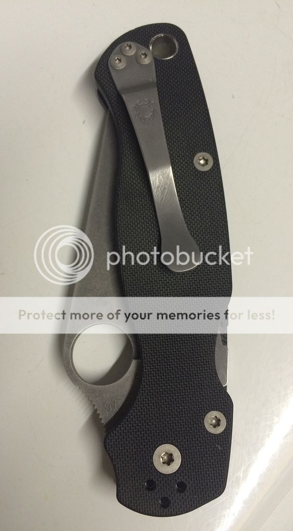

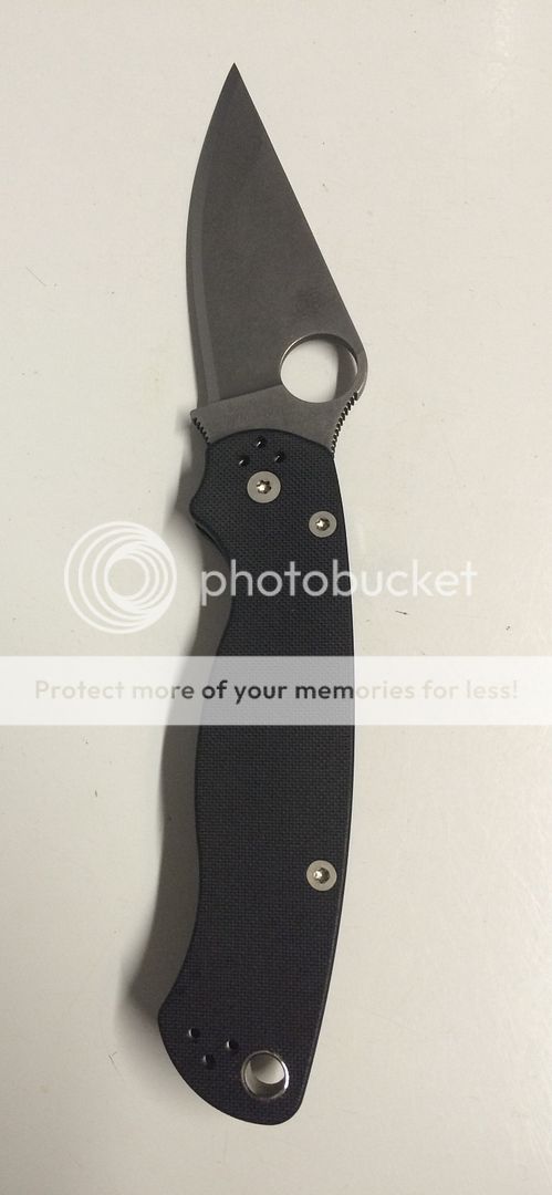

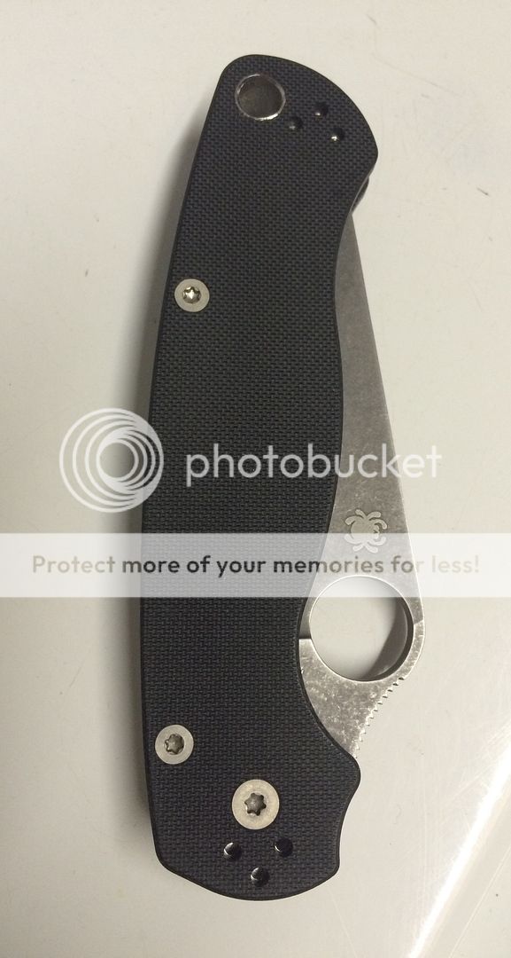

I rinsed the scale thorouly and when dried it looks about the same... I then took a scotch bright (the paint remover type) to roughen the surface a bit and the fading become more pronounced,... sweeet! it looks if the knife was left under the sun for years and that's a lot closer to what I want, a weathered look and it matches the stone wash blade really nicely. :) ps... I acid etched the screws and shaped and stone washed the clip as well to tie in the overall aesthetic.
This is after 24 hours in the bleach, didn't look a bit different...
The results: It doesn't show as well in pictures but the fading is a lot more pronounced
