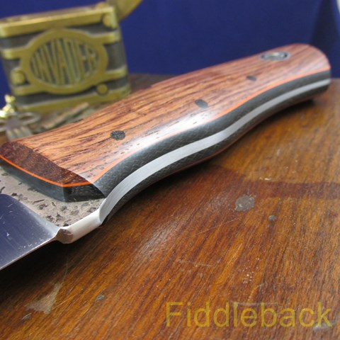

Of course you can. I have found that putting a very stable layer at the base helps to mitigate wood movement. Wood on wood, I find, moves quite a bit and joints suffer. Plus, since your portions are coming from ajacent portions of the plank, its going to be hard to match grain. If you use a liner or two to thicken it up, and those materials are stable, then your handle will be fine, and beautiful. I use superglue to do all my laminations. Then I use G-Flex epoxy to hold the scale to the steel.

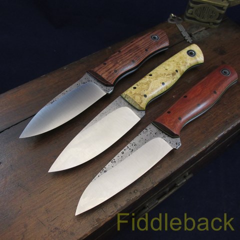

I love Rosewood. In the foreground of this pic, East Indian Rosewood over black g10 with a white g10 pinstripe.
Honduran Rosewood over black canvas with an orange g10 pinstripe. Here the micarta is 1/8" thick, then there is a 0.020" thick orange g10 pinstripe. That adds a lot of thickness. I was able to use a very thin slice of the Rosewood to get this scale. That meant an extra knife off of a block. ($$$) Honduran Rosewood is my favorite.
Here is a tip. When you are flattening micarta (it won't be perfect), one side is cupped and one side bulges very slightly. Flatten the cupped side first. Its way easier to do. Later on the other side is easier after you've cut away a lot of waste before glueup. To figure out which is which swirl the material on your surface plate lightly and check the pattern of scratches. If the scratches are in the center, flatten the other side. If they are round the edges keep flattening that side. The scratches should be level and even for the piece to be flat. Hold them together with two fingers and check for light around the edges, especially in the corner. The corners should be just as flat as the middle, or there will be a glueline.

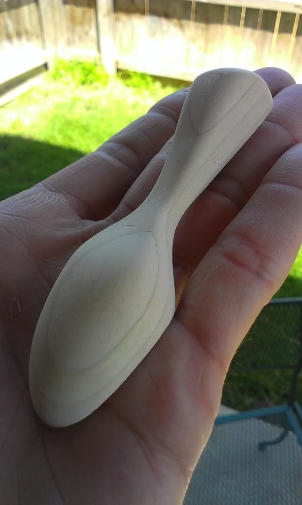

I find a simple beauty in "simple" woods like bass and poplar.
Carved poplar scoop.
I'd love to see your bass laminate.
