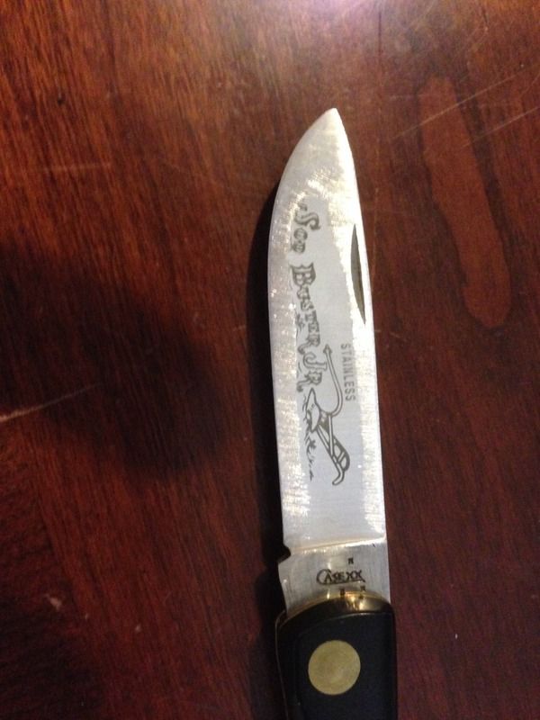

But one test stood out as having a marked difference in performance... whittling a piece of dried mulberry ( hard like oak, but with finer wood grain ).
Of all the knifes, the Opinel shaved off pieces of the mulberry like it was soft pine, while the others all really struggled to bite it, except the Ontario. Both the Opinel and the Rat II have full flat grinds, and I felt like I could lay them down at a finer angle than the others.
Of all these, I prefer to carry and use the Sodbuster Jr. the most for doing rough work around my homestead. I just love the look, feel, and carry of the Soddy for chores.
I'd like to know if it would be possible to adjust the edge of the Soddie to carve like the Opinel. The Soddie is a little bit thicker, but not as thick as the Ontario. The biggest difference is that the Soddie has a hollow grind instead of a flat.
Any advice is appreciated.

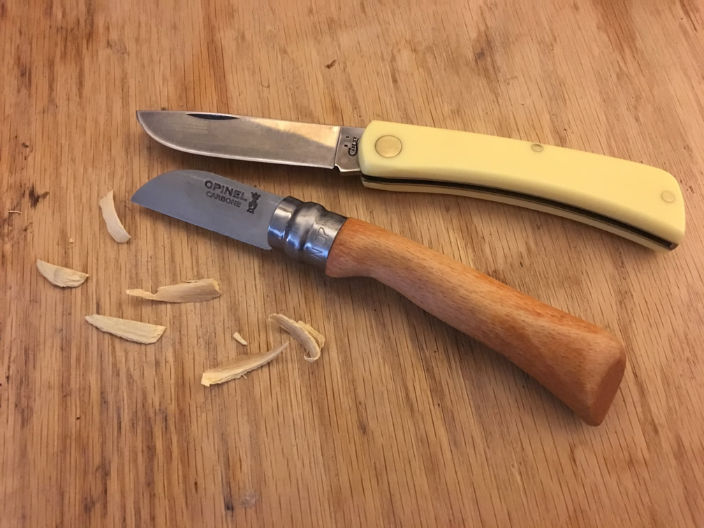

The Soddie is a little bit thicker, but not as thick as the Ontario...
The answer, in part anyway, is probably right here. Geometry (thickness) behind the edge plays a big part in how an edge performs. So even "a little bit thicker", combined with the angle of the edge, is probably the difference in performance between the two.
So, (unless there's something specific about these two knives I'm not seeing... I don't have either one), if you can thin the profile a bit, and lower the sharpened angle, you should hit the performance you're aiming for.
Thanks. I have a belt sander, but I'm planning to try doing it on a stone instead. I guess I should make a wooden angle guide at about 20° to start with.
The answer is right in your picture, the bevel on the sodbuster saw as a light ribbon on the edge is what makes the difference cutting wood. The angle of presentation of the cutting edge is a lot higher on the soddie compared to the Opinel which is practically a zero ° convex.
The wood is like a bundle of straws jointed together this is why even at the same sharpness(width of the apex) the Opinel is cutting them at a far more lower and favorable angle while the sodbuster is almost shaving across the grain (exaggeration).
My advice is: put the soddie flat on the belt sander and thin it down until it is around 0.010" aound 1/64" up from the edge and you'll get similar performance.
Knocking off the shoulders will help too
Thanks lutejones... it IS just a $20 knife, so I shouldn't be scared of putting it on the belt sander. I've got some finer grain belts that can do it slowly, and a dunk bucket.

Use the stone, if you can. CV steel this thin will grind very easily on something like a simple AlOx or SiC hardware store oil stone (back/forth scrubbing stroke is very fast; use the stone with oil). Won't take long at all to thin the soddie's edge to better geometry. If you already have reservations about using the grinder, I'd just avoid it. It's not necessary for a job like this, on this blade.
FYI, I have both of the knives you're comparing (my Opi is a No. 08), and have thinned the edges on both of them.

The Sodbuster has a hollow grind, so I'm interested to see what happens if you grind the flair where the cutting bevel starts down flat.
Well, I took it to the belt grinder and did a little bit with 150 grit (the finest belt I had), then put it on the stones to smooth out my amateur grinding. It definitely has improved the and there's still some more room for work on the stone just to even it out. I'd say its on par with the Ontario now.

i would do <10 degrees if you want to compare with the Opinel. I would try for a combined angle of 15-20 degrees then a 15 degree microbevel. The Opinel is probably only 0.05" at the spine with a full flat grind, so you are going to have to remove a lot of steel from the Case to get the same performance.
scott
From the factory anyway, Opinels are actually a shallow convex grind. It's subtle, but more easy to see with a straight-edge laid against the blade.
