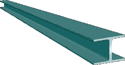

Exactly. The purpose of a fuller is to make the blade stronger.
It seems counter-intuitive that removing material will make a part stronger. But it does. Consider, for example, the I-Beams commonly used in construction:
They're less expensive than a solid beam would be, true. They're lighter than a standard beam would be, true. But, they're also stronger than a solid beam would be too.

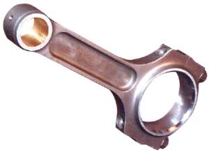

You can see this in other parts. Here is an engine connecting rod.
Notice the "blood grove?" That has nothing to do with controlling blood spray in covert deanimation missions and everything to do with actually making the part stronger.

That isn't entirely correct.
I-Beams and connecting rods are made with an "I" profile because this is the shape that offers the best combination of strength, weight, and ease of manufacturing. A solid steel beam with the same exterior dimensions of a steel I beam would be far stronger, but much, much heavier.
I shaped profiles don't provide a higher ultimate strength, but do provide a much better strength to weight ratio.
The I profile maintains a surprisingly high level of strength and stiffness because the two surfaces which are left solid are the two most highly-loaded surfaces in a beam element, usually the top and bottom.
The paper example just isn't applicable, because you aren't removing any material. The paper still weighs the same as it did, it just has a better load-bearing geometry.
A better example would be testing a steel beam under load and them milling some grooves along its length and testing it again. It will not hold as much weight.

That, too, is only part of the answer. Breaking strength isn't the only factor. Load and the deflection the load creates in the beam are much of what an I beam is about. So the folded paper's STIFFNESS under load is very much an example of the fuller's effect. This enters into moments of inertia as they are called in materials engineering.
Solid beams/objects are much easier to deflect/bend than hollow circles (pipes) and I-beams of the same cross sectional area.
Phil
This is interesting, perhaps I've misunderstood.
I agree that for a given length an appropriately formed I or O shaped element will deform less under its own weight compared to a solid sample. For example, given a 15' beam supported at one end will deflect less under it's own weight if it has an I profile compared to a solid one with the same exterior dimensions.
Also, for a given cross-sectional area a part will be stiffer if it has an I or O shape rather than a solid shape.
However, for a given set of exterior dimensions a solid shape will be both stiffer and stronger.
A given shaft or beam will not become stiffer if you bore out the center or cut grooves on the side. The stiffness per weight may increase, but the ultimate stiffness will go down. This is what happens when you mill or forge a fuller into a knife blade.
I beams (and other narror ridged structures) have a high strength than one would expect for their mass, but are more vunerable to torque stress. That's why I beams are used in pair. The fullers on swords and knives aren't really substantial enough (proportionate to the geometry) to affect stiffness. Better examples (from both nature and human stuff) are clam sheels and corrogated cardboard. Corrogated roofs are an example of groove making metal stiffer - thin metal, BIG grooves.
I think fullers are simply for weight/balance and aesthetics.

Fishbulb,
We are comparing apples and oranges.
You are correct when you compare total exterior dimensions. I am correct when you compare areas of a cross section: the method of computing moments of inertia. A solid object in cross section has most of its mass close the center of gravity in comparison to an I beam of the same cross sectional area.
http://en.wikipedia.org/wiki/Moment_of_inertia
Read down to the section on "Area Moment of Inertia" for a very brief indicator of how this works.
