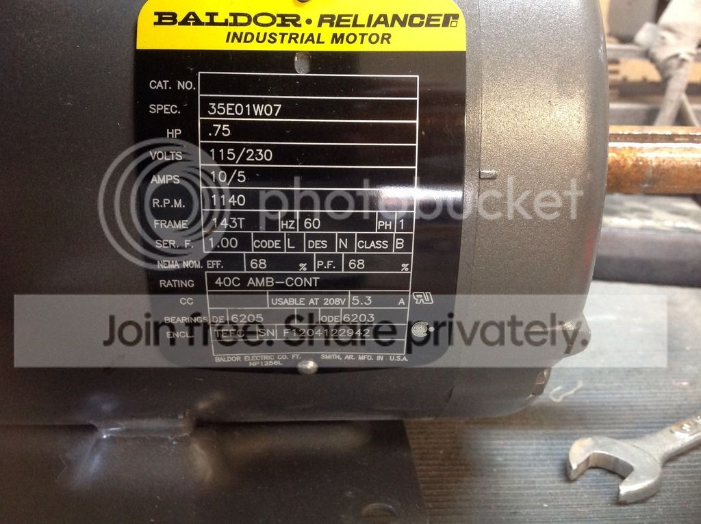

I am wanting to build a disc grinder and have 2 motors. I have heard I can disconnect the start capacitor and spin it the direction I want it to go before starting. Anyone know if this is correct and how to do it?
Speaking motors the term you are looking for is rotation.Reverse or forward rotation in term of the load on drive end.Yes you can tell me what kind of motor it is and I can tell you how. I'm assuming you're motor is capacitor start since you mentioned capacitor?I'm assuming it's a alternating current motor , single phase.if you're not certain send me a picture of the name plate. Do you want to be able to change the rotation from a switch?

I'm just assuming it is. This is what I have. I would rather have a variable speed but I already have a motor so this is what I'm going to use if it will work. Doing it with a switch would be awesome. Excuse the terminology as I am a mechanic. It bothers me also to hear folks use the wrong terminology!

i will send you the motor print with the opp and std for high and low and walk you throug connecting it if you need help. Very simple ... as easy as interchanging 2 wires :rolleyes:
