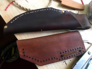

Here's the result of my diluting experiment. I'm pretty happy with the results. Took a lot of diluting to get the brown even this much lighter: this is about 4:1 denatured alcohol and Fiebings "dark brown" dye. The smaller sheath is done with the diluted dye.
