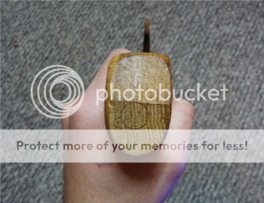

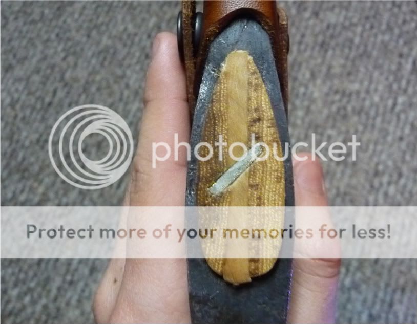

Here's my Gransfors Bruks Scandinavian Forest Axe which has very ideal grain pattern. My SFA has even straighter grain, but I don't have pictures of it handy

Looking at the center end grain ring you should be able to follow the line of the ring fully down both edges of the helve. (at the pole and bit the wood is called edge grain) Next follow the two on either side; they too should remain continuous- not exiting the side. continue following the rings end for end until you find the one(s) that do. Notice it makes an "arrow point >>>) on the face.(the surfaces with arrow points are face grain)
If the helve is completely true those arrows points will be centered on each face. But usually what you see is some slope to the edge grain, with bias that runs out on one side or the other. Shaping cuts through the ring-this makes the point so naturally not every ring will run continually end to end. Slope is different though = bad.
