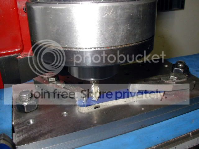

I make traditional slipjoints and this is a picture of my mill. A small 6 x 26 "knee mill" import. The knee mill refers to the fact that the table is able to be raised and lowered versus the head being raised and lowered as on a mill/drill. The second picture is my tooling plate that I made up along with clamps to hold the frame material that I mill to make the one piece liner/bolsters. The old traditional way of doing it would be to solder the bolsters to the liners.
both yield good results if done right. I also use the mill to cut the long nail pulls in the blades.

I will take a picture of the fixture I use when cutting the long nail pulls and post it. The blue material is cut from a piece of printers blanket . At least I think that is what it was called when given to me.
Its a blue rubber with cloth back

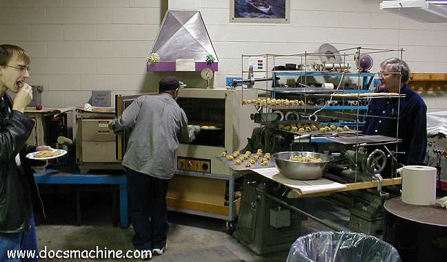

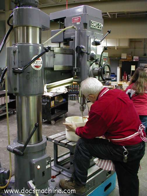

And my favorite use of a mill so far is you can mount a stir in a chuck and mix epoxy with it. Okay, that's not really my favorite, but I'll bet you never thought of it...
-How about using a 7HP Radial Arm drill to mix up two gallons of chocolate-chip cookie dough at a time? :D
Then use the shop's heat-treating ovens to bake 'em?
(Note what the cooling rack is attached to. :D )
That was an event the local Community College machine shop put on a few years ago, a sort of open house, which was a big hit. We baked something like 300 dozen cookies that day...
But I digress. :)
Doc.
