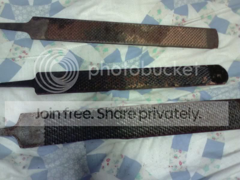

Can someone name the steels in these files i found?
J.McDonald Knives
Basic Member
Jan 28, 2007
2,021
my uncle had these in with the scrap metal pile. from top to bottom the brands are Nicholson, Slack legend, and Save Edge. i would like to make a pig sticker out of the nicholson but i need to know what steel it is. i also want to make some knives out of the other two if they are good steel. all three have a rasp on one side and regular cross cut file teeth on the other side. the nicholson is 17 1/2" long and 1 3/4" wide. the slack legend is 16 3/4" long and 1 5/8" wide. the save edge is 19 3/4" long and 2 1/4" wide. should i anneal them first before working on them? thanks for your help.

read and try that works there have been many threads about this stuff but my word is dont bother (you have good steel not files )
The search function here at the forums is a wonderful thing. I've used it before and found out that (current) Nicholson files are 1095.
However, these looks like rasps, which may only be case hardened. The only way to tell is to test them and see if they harden. I know that sounds suspiciously like work, but sometimes you just gotta do that in order to figure it out.

For the first year and a half; I forged about anything that would, get hot, spark or attach itself to a magnet. Now that I have a fair understanding of what it is, that I am trying to accomplish I use only known steels, with, known heat quantities.
If I were to have the opportunity to redo that first year and a half at the forge, I would acquire only known steels and forge them.
If you work with steels that are identifiable; your forging and heat treating skills can be amassed at the same time. Having one skill without the other makes one a less than accomplished bladesmith.

There is no way to know (The file question pops up about once a week). Just use your 1075. It will be as good as any file, and you know how to do the HT. Leave the experiments for several years and several hundred knives later.
I have people bring me all kinds of steel from cranes, tractors, industrial plants, nuclear reactors, etc. I smile and say thanks. Then I put it along the wall of the smithy. That big stack of steel looks impressive. When I want to make a knife I pull out a piece of steel from the metal rack ( not the wall stack), read the marking ( I mark both ends and both sides), and proceed with a surety of what it is and what to do to it.

file knives are just so darn risky...
To tell the truth, every story I have heard from my friends or co-workers who had owned a file knife always ends the story the same way..."It was great until it snapped"
I know that there are some bladesmiths that swear you can make a great knife from a file, and I know lots of people try...
But I just think it's a lot of work for a blade thats real tricky to pull off right.
Look at how much work they are, only to have them snap on you like that.
I swear if you break another file knife you may have a heart attack on us...
I suggest a easy steel....and an oil quench...and a 400' tempering for 2 hours!
