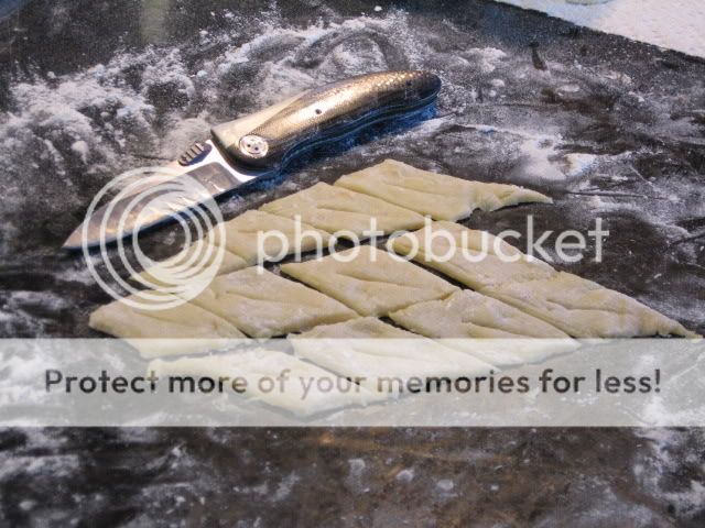

Making Christmas cookies and camping with a Damasteel Elishewitz custom:

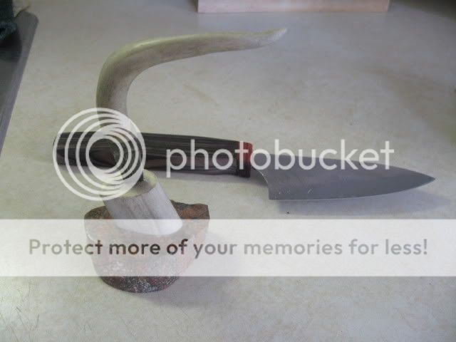

This is the most used utility knife in the kitchen (next to the most used kitchen knife):
