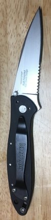

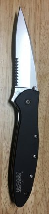

Thank you members for your advice and encouragement. I cleaned it up with wd40 and a green scotchbrite pad. It’s not great, but acceptable and so I’d say this knife is usable if not saved. The action is smooth but not as snappy as new. It’s going to be in my pocket for a week or so to work in the lube.
It was a great learning experience to take it apart and reassemble it. I may take it apart again to see if I can do better cleaning and get the opening to snap.

Haven't done it myself; but, there are lots of videos & other instruction available on Youtube, and here, for 'tuning up' the action on these, to make them faster/smoother in opening. Others may contribute some links on that, so you might keep watching here. Stuff like polishing the bearing surfaces in the pivot (sides of blade, bushings/washers, etc). That might be helpful to you in the next round of rehab for the knife.

Looks a lot better. :thumbsup:
According to the scratch marks on tang/pivot, looks like you used sand paper.
