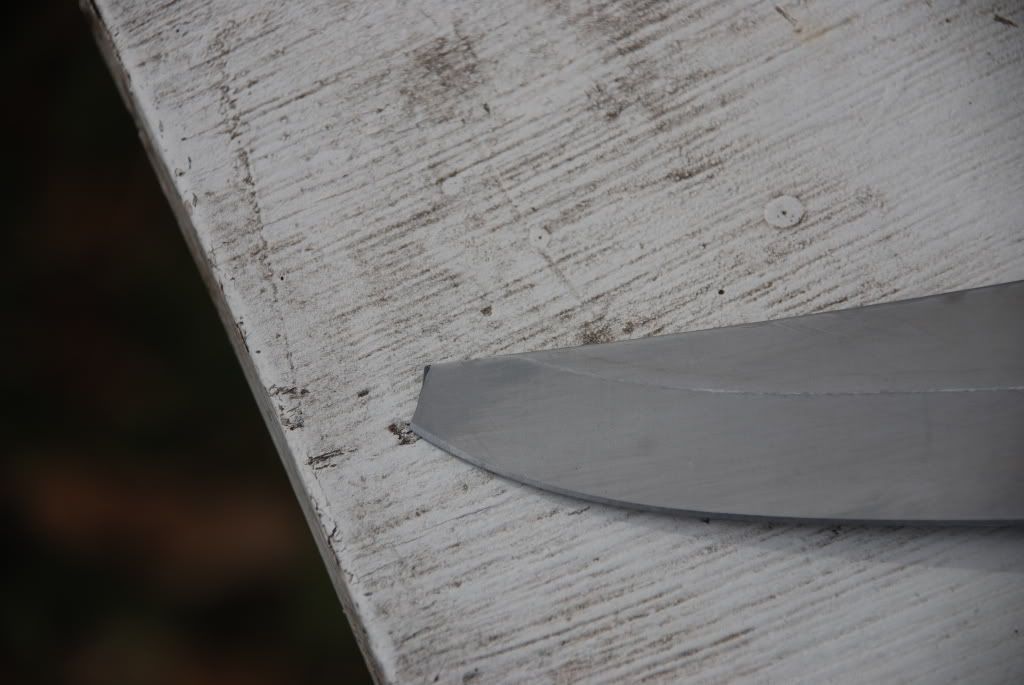

Here is a 2 bladed selector handle I found on my travels yesterday. Problem is the tip is broken off the fixed blade. Otherwise it's not in bad shape except for a scratch in the Valox on the backside. I already have a nice one in my collection but couldn't leave this one lie for not much money. The two bladed handles are less common. Question to the rest of you is what can I do about the tip? I have no experience with this. Will Buck reshape the tip for a fee or is there someone else to send it to? Too nice of a knife to end it's life this way.... :) What do you all think?

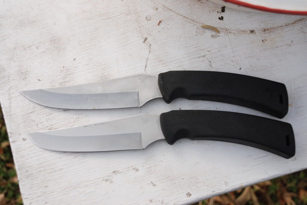

Here it is (bottom) with a new one, showing what it is supposed to look like.
Nice job! I have a 112 that I reprofiled and the tip is a little blunt! I'm going ta go back and take some more off to get it more pointy! Slow and steady is the trick. You can always take steel away; but you can't put it back!!!

OK, you all gave me the courage to give it a try. It was something I would have thought took special grinders or whatever. I have never broken a tip off a knife, but then I consider a screwdriver to be a "proper" prying tool. :) A file didn't work, it just skated accross the blade. I did have a diamond thingy from Harbor Freight laying around that I had never used. It was not very coarse. It took me about an hour to get the blade to what you see in the picture. I do not have a good edge on it yet. The blade now measures .24" shorter than the blade on my other Selector handle. The new tip is just barely covered by the handle sides.

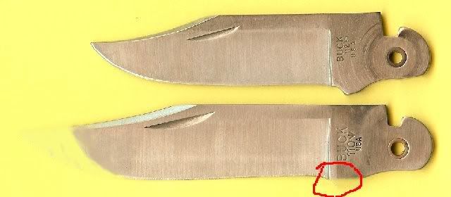

Looks great Desoto! If after time and sharpening/ blade wear the point becomes exposed a little, and if your brave the blade can be lowered into the handle. This is done by taking down the "kick". That's the flat part of the blade between the sharp edge and the handle. The test I use to see if this is feasible is to depress the blade while the knife is closed to see the available travel before the edge contacts the spring or lockbar. If done improperly every time the blade snaps shut it will dull where it makes contact !

Here is a pic some of us were talking about once, as to how to lower the tip inside the frame.
But do it a little at a time...
