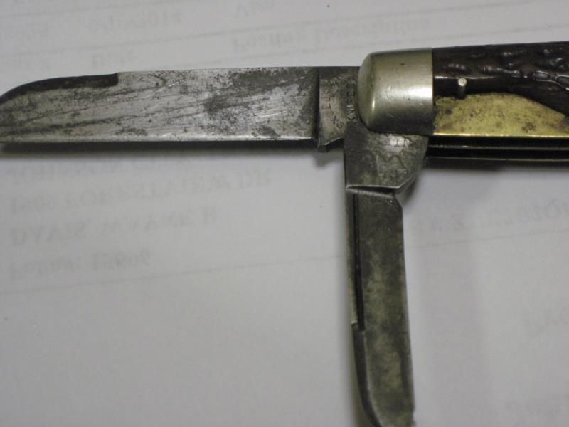

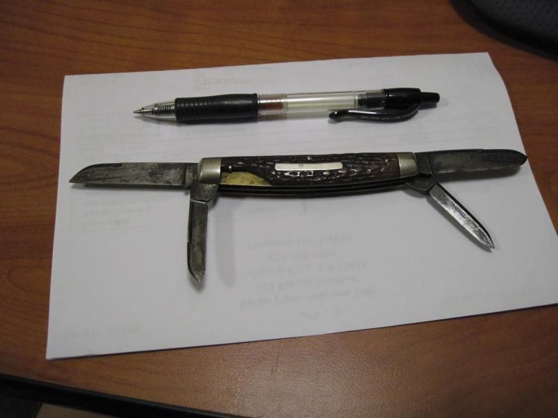

This is my very first knife. I found it while fishing on the banks of the Ohio River at Schooner Point in Indiana about 50 years ago. I was seven or eight and retained the knife for at least 20 minutes before my mother snagged it. My dad kept it, along with my second knife, until he passed. He kept them all these years. I just got them both back.
Although badly rusted and both scales broken when I found it, three of the blades still snap and are actually fairly sharp. I would appreciate any suggestions regarding repair from the board experts. I want to do it correctly and am willing to spend some money to do so. Here are several pics to give you an idea. I'm on a very slow connection, so it is taking forever to upload to photobucket.

It's in useful condition now, I think. You could clean it and sharpen it if you intend to use it, but while replacing the broken scales could make it pretty, I think it is better the way it is. I've had knives with no snap, that came back with a good cleaning and a bit of oil, plus use.

Thanks for the reply WMB. I agree with you that it's best to leave vintage stuff as found, if possible. The problem in this case is that the scales broke at the pins and the pins slide in and out. Blocks the blades from closing and snags my pants pocket. I guess I could have them peened or epoxied in place. If I do that, I might as well replace or repair the existing scales. I'm way out of my league with this stuff.

I just had an idea. You could probably solder the pin in place fairly easily, if you wanted to avoid taking the knife apart. Place the pin where you want it, heat it with a soldering iron, at the base against the liner. Introduce a small amount of solder from inside. It will be drawn into the joint.
