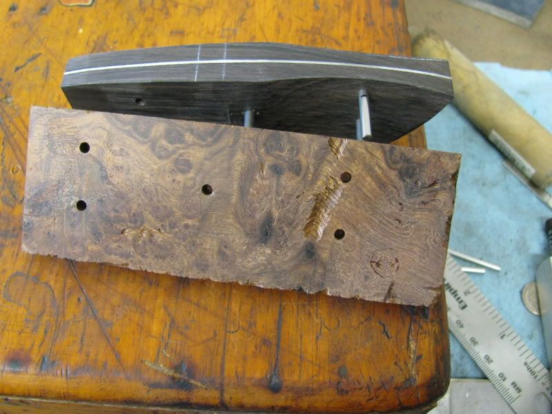

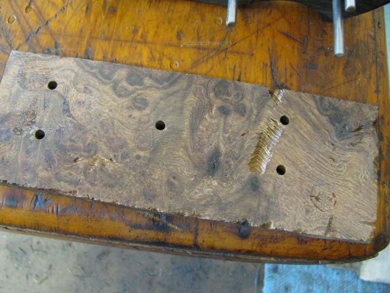

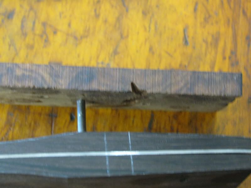

This is the only one left in the shop but here are the pics.
That's strange looking. That just popped out? The one pop out looks like it's bordered by the one drilled hole. But that's an awfully odd chunk to go flying out. I'm confused! :)
That looks like tear out to me.
Are you milling, planing or sanding these flat?
Figured woods can have tear out when the edge of a cutter catches the wood and pulls out chunks.
I am not explaining myself very well.
That is not checking ( at least what I call checking). It is tear out. The wood is being split away from itself. Sharp cutters/drill bits/belts, proper feed rate and speed, avoid pressure. That is where the culprit lies.
Woods with burl and such will do this because there is already a stress in the wood. Heat is another part of the equation, causing the piece to pop right out. DI is particularly prone to pieces popping out.
BTW, checking is tiny cracks caused by uneven heating in grinding and finishing as well as by uneven drying.
