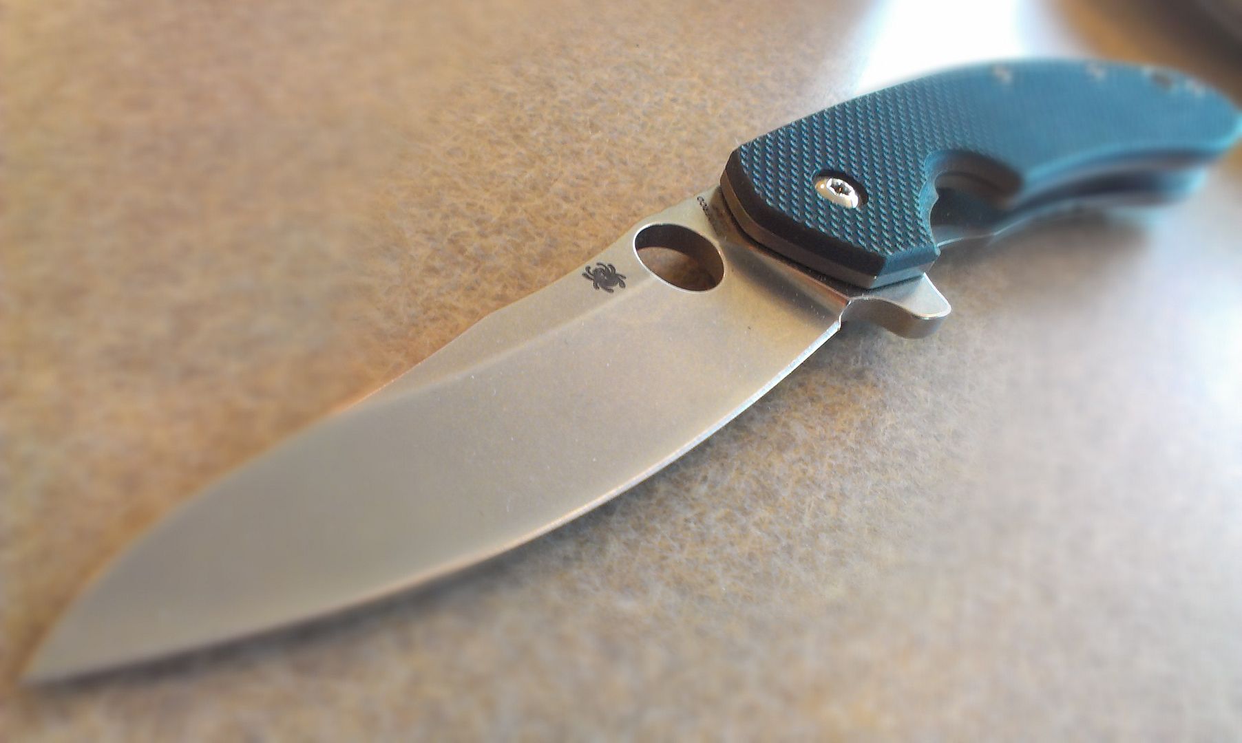

I used "Kelly Green" on my Southard. The stock color is a light brown. I'll see if I can find a pic.
Edit- this is the only pic that I have handy, but you get the idea.
