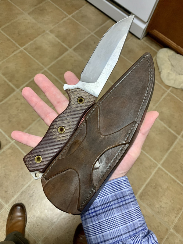

I searched to see if this was discussed before but couldn’t find what I was looking for.
I have a sheath that is a dark brown color. I would like to make it lighter but don’t know if that is possible. Is there a way to either pull the dye out or maybe sand it to lighten the color?

Got pics?
That sheath would have to be done chemically. There is no way you can sand in all the low spots.
I'm no leather expert, but if it were mine, I would soak it in a bowl of 90% isopropyl alcohol and see how much dye comes off of it.
If the dye is soluble in alcohol, you would probably have to do this several times.
Acetone might work, too.
I doubt either one will hurt the leather.
Nice sheath. I do have a friend that sometimes takes a palm sander to leggings he makes. Done judiciously it kinda can come out like nubuck. But he’s doing this prior to construction. Like Bill said you’re not gonna get all the low spots by sanding. Bad for the thread too. You could take it apart and then sand all the pieces and then put it back together. But then ya might as well make a new one. Are you trying to match a belt or something? Might be more practical to darken the other item.

The OP's sheath is heavily dyed. So heavy that it looks painted.
I'd certainly try Bill's method on the belt loop since that won't be seen when worn. If it works, great, if it doesn't or makes a mess, little harm since the belt loop is out of sight while wearing it.

I think I will try soaking it in alcohol and see what happens. If it comes out horrible I have some black fiebings.🤷‍♂️

Looks like it was brushed on with a dauber. I don’t think it was sealed afterward either - it rubs off on my fingers on hot days.
When I first got the sheath it was so full of smoke you’d think the Marlboro Man himself owned it. That has faded to a tolerable level, but I’ve never liked the color.
If an attempt to lighten it doesn’t work I’ll go the opposite direction and just dye it black and seal it.

The dye transfer is one of the reasons I quit dyeing leather years ago. Even sealed it can happen. Plus my empirical evidence shows that a dyed leather product, used hard, has about half the life span of that product not dyed. Seen it often. Tannery/drum dyed leather is much more stable. That scrap above is dyed russet, (drum dyed by the tannery). That's the standard leather I use. Wicket and Craig russet skirting leather in 8/10 oz.

This will be interesting. I've stripped some color off of leather with acetone before, didn't really hurt the leather either.
I’ve been flipping it all night every hour or so. Gonna leave it on one side and flip it in the morning.
It IS giving off a lot of brown into the alcohol. It doesn’t seem to be changing much when I scrub the exposed side with a paper towel, but it’s all still wet.
