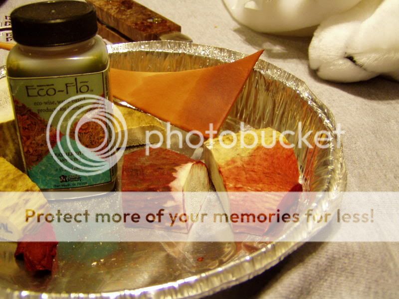

How red do you want them? I tried the "Eco Flo" brand leather dye in 'Canyon Tan' and it turned some well aged elk antler quite red.
This was a first try, wipe on and let dry attempt. I didn't pursue it further...
