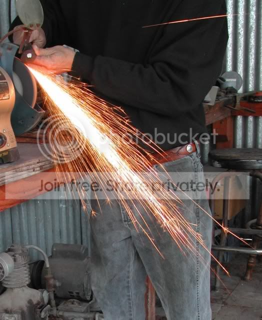

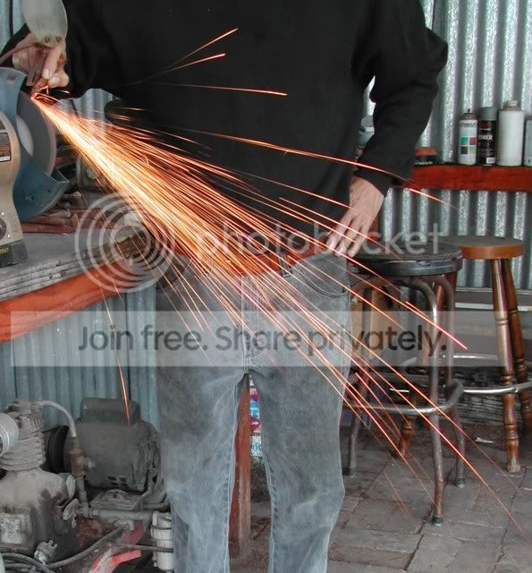

Looks like medium carbon to me, anywhere between .35 and .65,... be my guess. The medium carbon steels tend to spark a lot the same. I'd quench and hardness test it,… air, oil and water, before I'd try to make anything out of it.

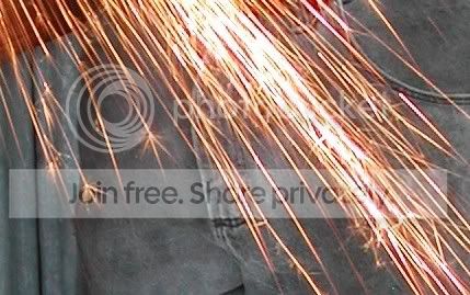

If the sparks were burning out closer to the wheel, it would indicate higher carbon content. The medium and lower carbon steels throw sparks further from the wheel. You can't always tell by the branching and starbursts.
Here's a piece of railroad spike steel.
Here's virtually no carbon.
Look at the distance from the wheel, and the lack of starbursts...

The first time I ground a differentially hardened 1095 blade it took me a few seconds to figure out what was up with the different sparks from the hard and soft areas.

It sure does look like HC steels fairly consistently spark more dynamically when hardened than when soft. The hardened 52100 spark density and intensity was amazing. It's nearly pure white light, almost as if magnesium was burning!
Makes me wonder if tempering to more or lesser degrees would affect the spark too. I know for a fact that the 1084 and 52100 hardened samples were not tempered, both were blades that I broke after hardening, as far as I recall, the other hardened blades were tempered.
