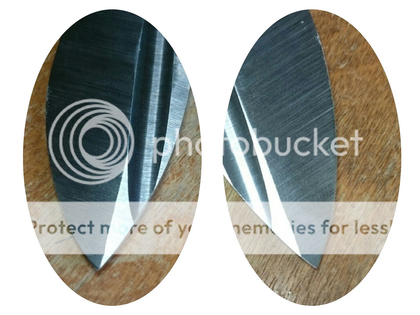

Hi guys and gals,
I am offering these services (thread started in June 2014):
- dark acid etching and stone washing blades
- titanium blasting
- titanium anodizing
- sharpening on the wicked edge
- stone washing/sanding/scotch-brite-ing flats after anodization
Prices will vary: basic easy sharpening starts at $25. Thickness of blade stock, bevel consistency, desired finish, and hardness of blade steel will influence price.

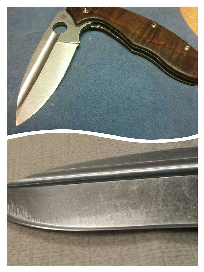

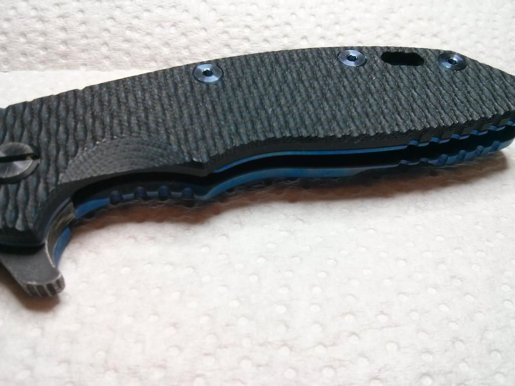

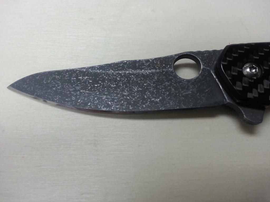

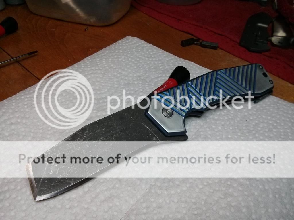

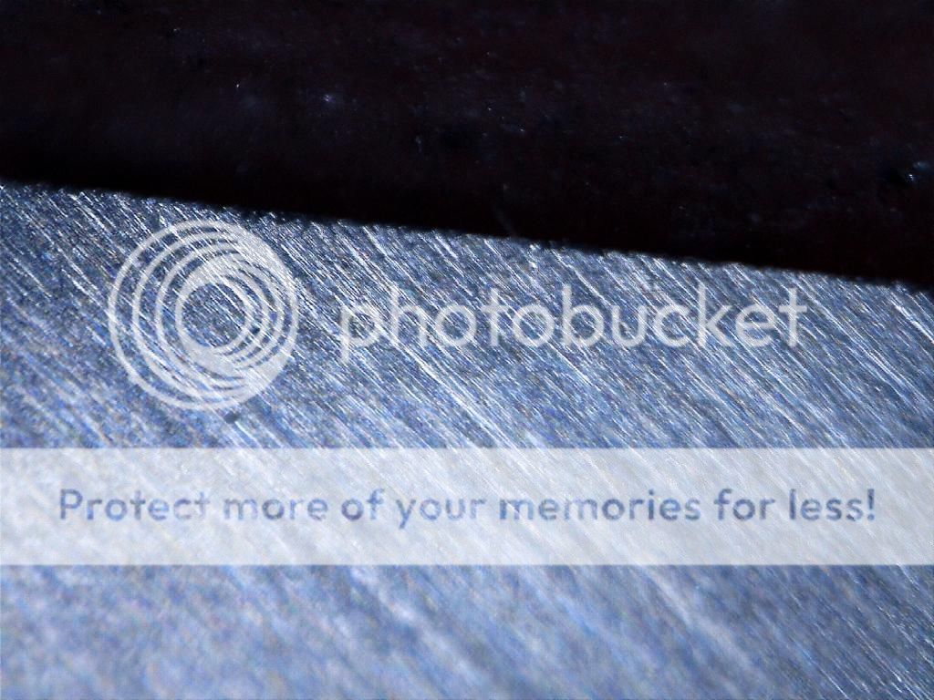

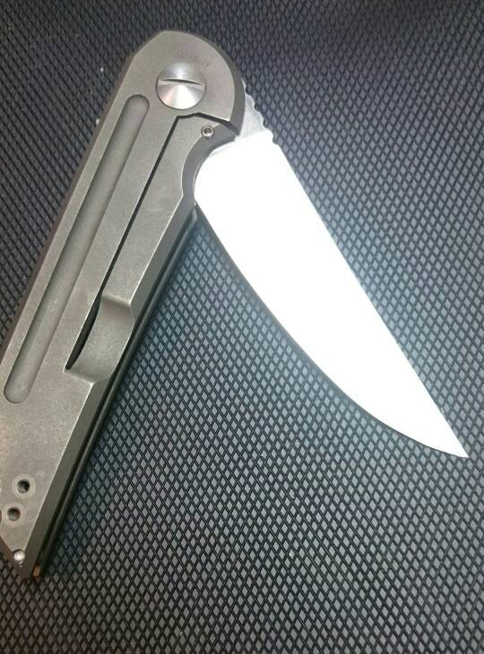

Here are some examples of my work:

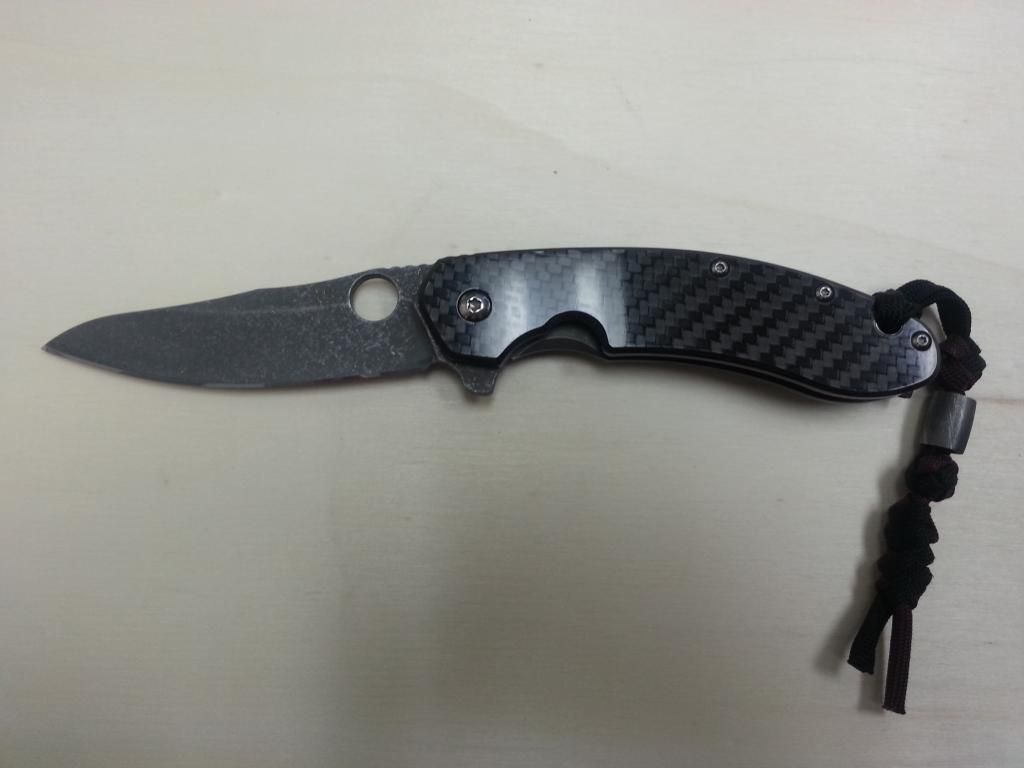

Here is a Graham Razel midtech with blue anodizing, sanded flats, and a dark acid stone washed blade.

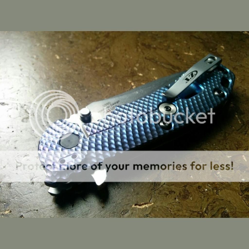

JD's Sebenza 25

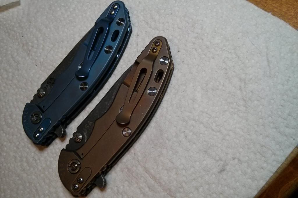

Phil's Southard. CTS-204P does not get as dark as other steels because of a high chromium content, but it still looks nice in my opinion.

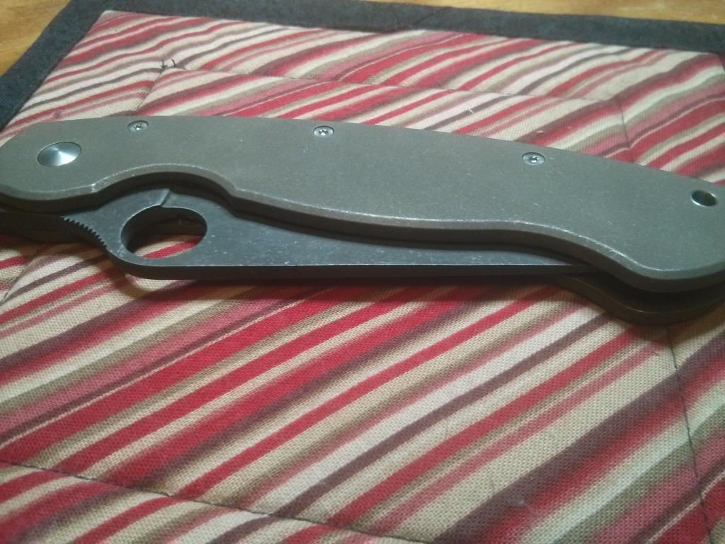

Titanium Military with dark acid etched blade, blasted, anodized and stone washed handle. I have also made this a tip-up Military. Pictures to come once I receive the proper low rider clip.

Acid stone washing is relatively easy. Ferric chloride in an olive jar. Mix the powder about 3 to 1. Let the blade sit in there for approximately 1 hour and tumble or shake for 30 seconds or more. Just remember metal with high Cr will not get very dark. No matter how long you soak them and don't go to long or it will eat under your nail polish. I've gone 1.5 hours and taken the blade out, repainted it and put it back in.

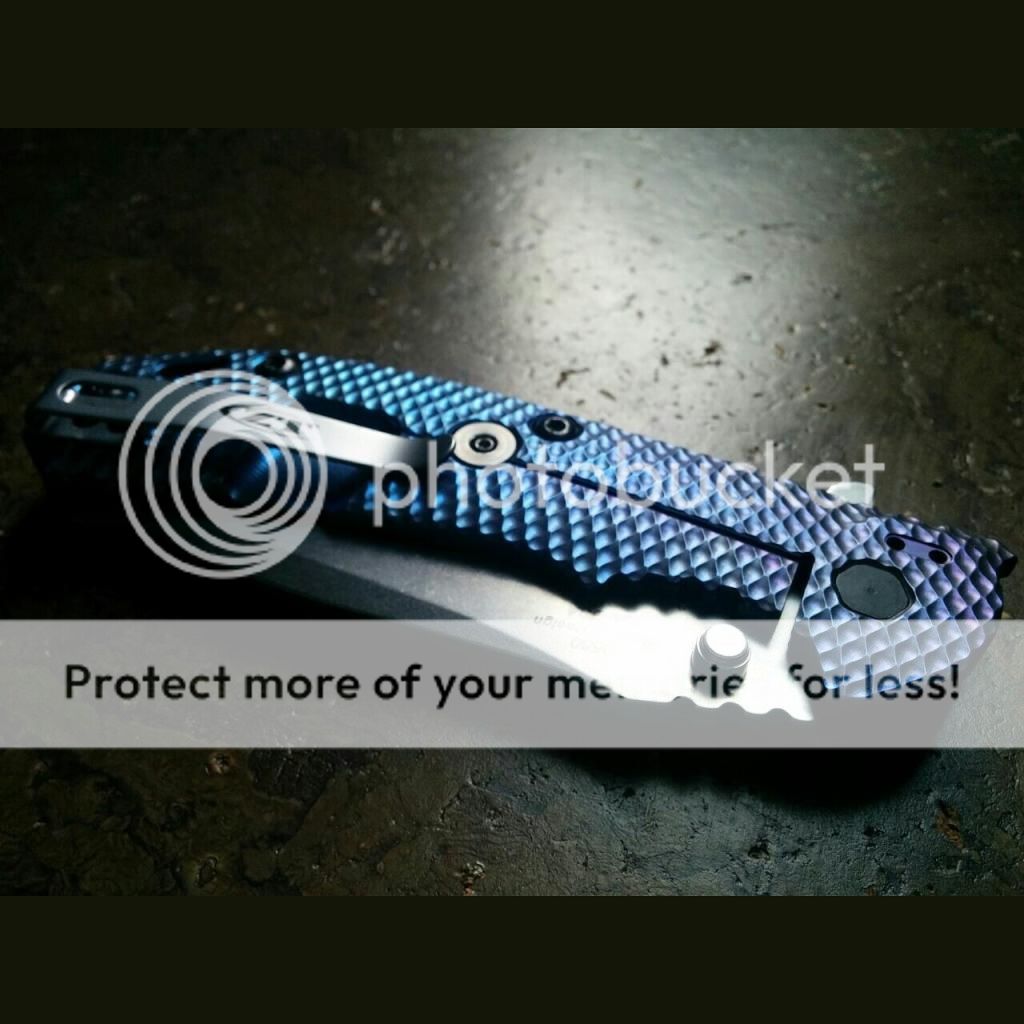

I really enjoy the projects. This one is blasted, anodized, tumbled and scotch-brited. We can come up with a price together. Maybe shoot me an email.
Here's another ano job.
12 different voltages of blue...
