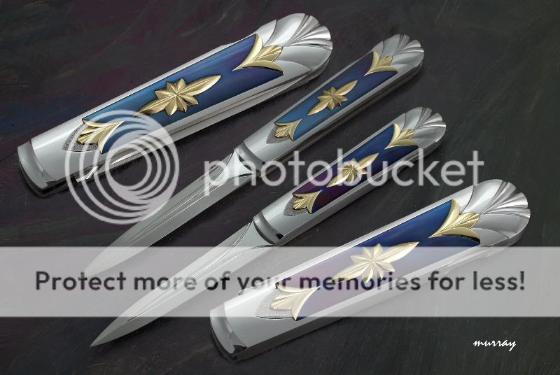

I completed this knife for the CKG show. It was shown in the show report by Robert, and there was a question regarding the inlay panel.
I have been researching old methods of decorating sword blades and fittings. Three methods that were used to obtain a blue/black finish consisted of hot sand, charcoal and rust blueing. Each of these provides a different effect. Sand and charcoal blueing involves heat soaking the steel for several hours. The slightest amount of contamination in the packing material will result in a flawed finish. Because of this it took several attempts to achieve an even finish on the panels of this knife. For each attempt I had to sand off the finish and re-polish the steel. Given the amount of sanding required to remove the finish, I am confident that it will stand up well to normal handling. It It is interesting to note that the colour will change depending on the angle that it is viewed from.
I will be using these new (for me) finishes in some of my upcoming new designs.
Thank you Murray for taking the photo before the knife was sold.
Wolfe

That charcoal blued steel looks amazing in the picture, must be quite spectacular in person.
I was lucky enough to see and handle this knife in person. Not only does it look great, but it is so smooth with a very crisp lock up.

I assume the inlay is carbon steel instead of 416 stainless?
