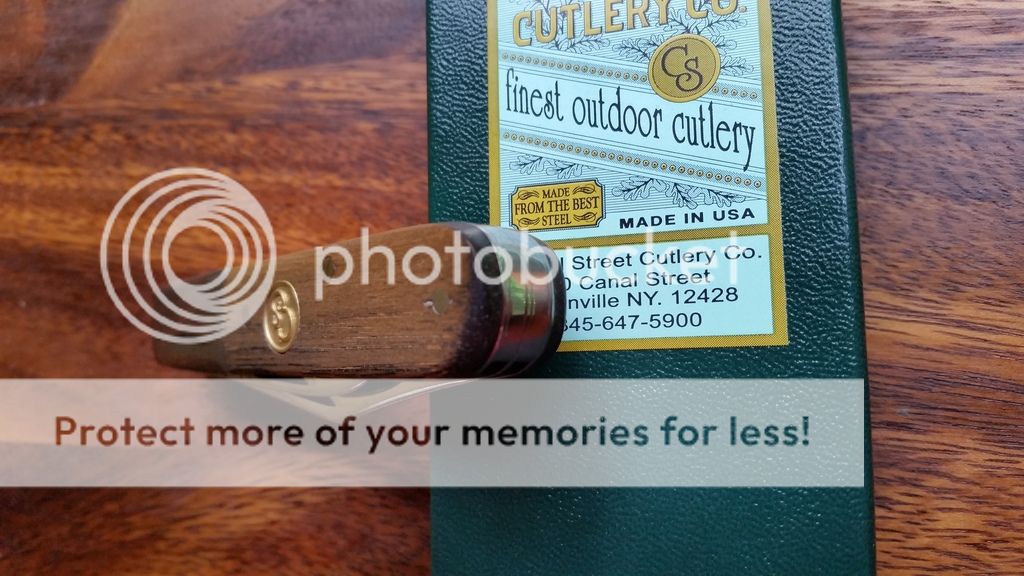

Today it arrived. It came in a beautiful textured box with a label harkening back to the early 20th century. CSC definitely has style. Inside was the black jewelers pouch with gold embroidery and the story of the reclaimed chestnut used for the covers. Also included of course was warranty paperwork and description of the knife.

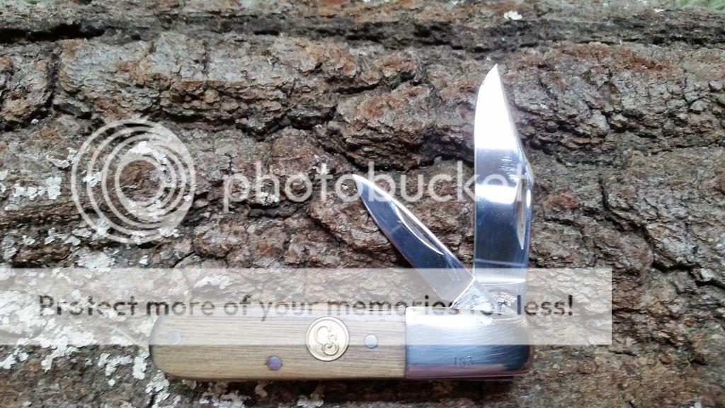

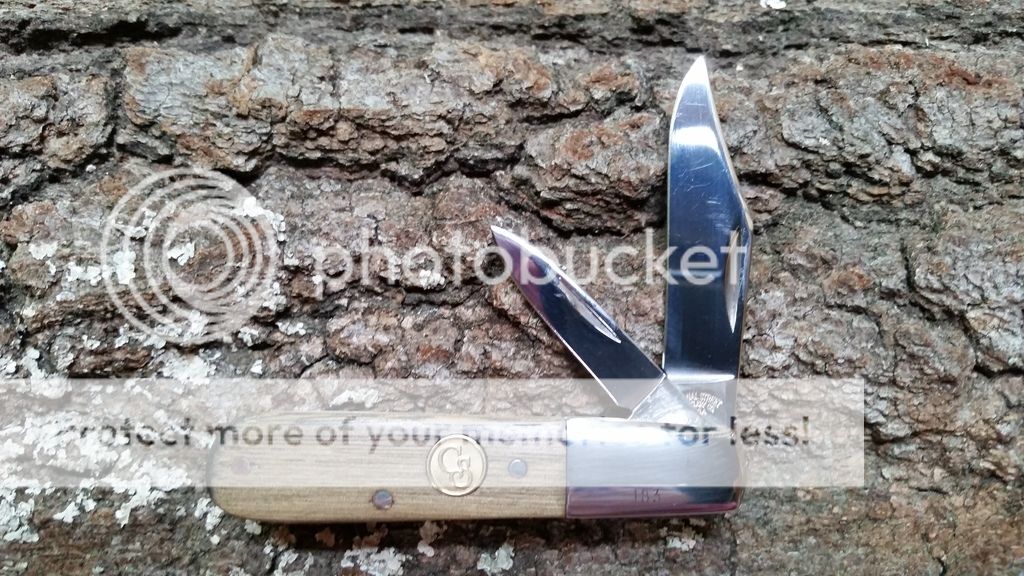

My initial impression was that it was a beautiful knife with a lot of heft. This is a very solid knife. However, I was mildly disappointed that CSC has moved their logo from the bolster to a brass coin in the cover. The pictures I'd seen before purchase didn't have the coin. Also the serial number 183 (apparently all CSC knives are serialized) was in a different spot than I expected. I was thinking it would be on the edge of the bolster or rotated 90 degrees and placed near the seam near the cover. It's not a deal breaker, but I just prefer embellishment on the bolster of a Barlow.

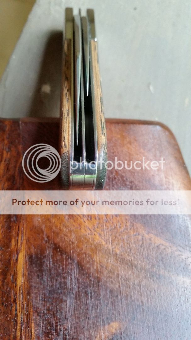

Looking over the knife, I noticed the covers were a little scorched from what I assumed being left on the wheel a little too long during finishing. I prefer it not be that way, but it does add some character.

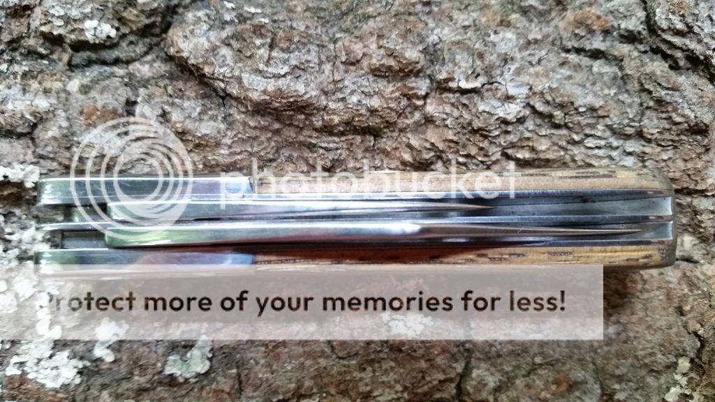

No gaps or light. This is a tightly built knife.

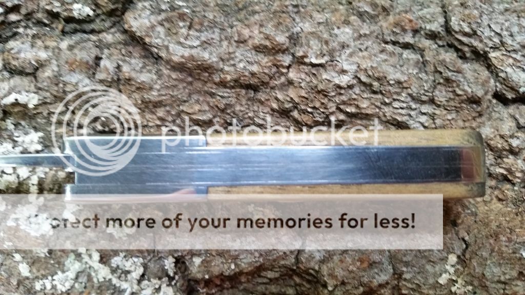

The 14-4CRMO blades are dead center, however if you look closely, you can see a slight curvature near the tip of the main blade. And, there is a faint scuff just NW of the nail nick that I have no explanation for as nothing rubs. I actually couldn't see it until I started taking pictures of it outside and it caught the light just right.
I'd rate the pull at around 6-7 for both blades neither of which have half stops. Both blades are sharp out of the box, but not shaving sharp. They'll both see some strop time first to see if that can be rectified and stone time if not. Walk and talk are excellent on both blades and there is no play at all. Additionally, the spines of both blades end very close to the bolster when closed minimizing sharp corners. So it's comfortable in the hand while closed as well.

I believe the "burnt" areas at the ends of the scales is actually the end-grain of the wood. Certain woods do this more than others (your wood appears to have a very porous grain): the end-grain will absorb the stain and buffing compound much more than the side-grain. I have beech Opinels that exhibit this darkening after just a bit of handling and buffing while my Olive Wood handled knives show no darkening in the end-grain.
Thanks for the comprehensive review. The burnt areas do look end grain, and I think the coloration adds a lot of character to the knife. Keep in mind this chestnut is almost 100 years old. Its history is as follows:

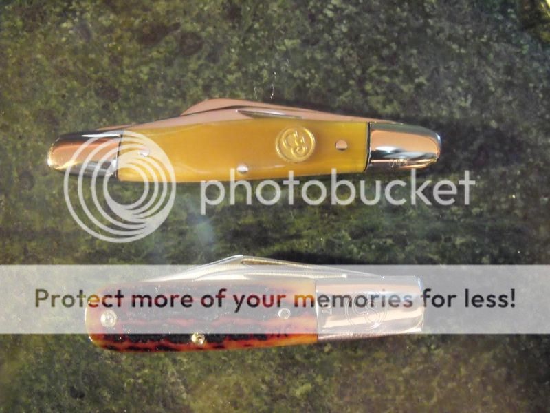

Just to show what the OP was saying about the bolster being engraved with the CS mark, here is my CSC barlow with engraved bolster.
