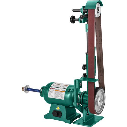

cannibalizing a grizzly grinder?
operator error as it may, but im really hating this grizzly. my belts have tracked off several times to the inside and started cutting a pretty deep grove into the frame.
anyone ever given any serious thought to cannibalizing a grizz 2x72 to make a better grinder? i think the motor is worth more than what i paid for it.
im thinking i could use the motor, add some step pulleys to slow it down. then use at least the top wheel. come up with the body and i would have something near a kmg clone?
any thoughts?

I'm with Bill. There is indeed a tracking adjustment, but it's not nearly as precise as the higher end grinders out there. I own a Grizzly, but I've never had any problems with grinding into the frame. Maybe some pics of the setup would help evaluate the problem.
To answer you orig. question, I've thought about mods to do to my Grizzly, but haven't really sat down to figure anything out just yet. Soon it will be a secondary grinder so I'm not too worried about it.
I picked up a used Griz grinder a few summers back. As I had to dismantle it to ship out to Hawaii, I found out first hand there are a few adjustments related tracking. There's the obvious tracking knob at the top. But what I had to monkey with was the two hex nut settings at the top and middle of the vertical shaft. The middle one is loosened to extend the shaft (higher means more tension and seemed better) as well as rotate the shaft. I believe the top one also loosened the top head assembly on the shaft and permitted rotation as well, but I can't remember for sure. Anyway fiddling with those adjustments and making sure the two wheels' surfaces are lined up with each other helped A LOT!

yes the grizz does have the adjustment. although mine is VERY strange. if i have it set just right to start, once i start grinding, or change belts (from like 40 to 200) it sometimes is completely out of whack and throws it off or into the base, depending on how i had the adjustment set prior. as the grinder is so fast, it happens just as fast and has ruined a few belts in a split second. while it is working right. the belt rides half way off the top roller away from the grinder and it is right on with the lower. i think that top head sags too much its old, maybe needs to be worked on. someone did tell me that i can use tape or something around the top roller to improve tracking.
i think i will use the motor with the addition of some step down pulleys and reconfigure the rest. but i have to do this as cheap as possible.
thanks all.
That does sound like the upper wheel does not have enough crown, for that thing to be so twitchy. If it did have enough crown the belt might track off to the side but it would happen a little more slowly. The tape in the middle of the upper wheel will probably help significantly.
