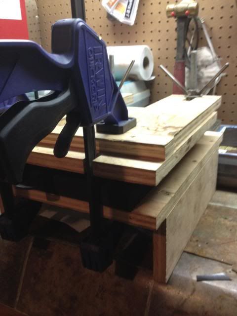

This is the second kydex sheath I have made for this thing. I swear I have spent almost three hours tweaking with a kydex, to come up with something that will make a solid "click."
I put my oven at 265, and preheat, put the kydex in there for 6 - 8 minutes. I take the kydex out of the oven, I put the knife in between the two layers of kydex, sandwich all of that between two layers of sheath foam, and then I put a piece of 3/4" plywood on top of everything, and I stand on top of the whole enchilada, and I bounce up and down.
Oven not hot enough? Need to leave kydex in there longer? Need to press this in a c-clamp or a vise maybe?

Very interesting. I have been leaving it in my "kydex press" for only a minute or so. I think I will clamp it, and leave it clamped for 10 minutes.
Definitely longer. I sometimes leave it for about 20 mins. Clamped tight as well. I don't think standing on it will get as good results as clamping.

Did some research and followed you guy's tips too. It's better now. I put the kydex in the oven starting at 170 and gradually raised the temperature to 290 while at the same warming the knife and foam with a heat gun. Then I clamped it, and left it clamped for 45 minutes. I could still feel a little bit of warmth when I took it out of the press.
Clamped it tight.
It has a much better click now, but you have to carefully guide it in by sight. Otherwise it goes in wrong.

We went to three layers of blue tape recently with good results. The trick is really the knife should be held by the bolster area, not the blade..We made a press that uses ratchet clamps on the front but also has two all threaded bolts in the rear with large homemade wing nuts that way even pressure front to back can be applied. We bought the foam made for presses and also eyelet dies and a small arbor press to use them in.. We figured out fast that is you want your kydex to look professional then you need good tools to work it with..
