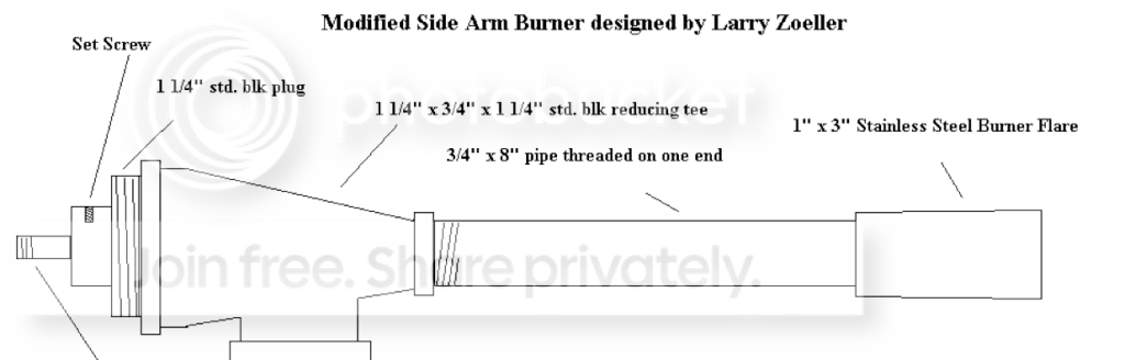

I noticed on this drawing of the Zoeller burner that the tube is 8" long whereas mine is 9". Would cutting the 1" make the difference?
thats odd that it wont light when the valve is all the way open. as far as length is concered 1" may make the difference. I patterend mine off of the zoeller patter, with exception that my intake opening is smaller, so I use a .028 mig tip. the end of my tip is 1/4" past the edge or the intake that is closer to the business end of the burner. on initial fire up, i have to close the intake almost completely for a few seconds to the right flame pattern at the end. I will take my camera to work tomorrow and take a couple pics and a video or two of the burner running.

Thanks David. I don't think the nipple I was given is long enough to reach that close to the burner tube.
I just went out and chopped an inch of the pipe, cleaned out the POL so the little ball and spring is gone, took off the angle coupling piece just after the ball valve and still it won't light with the 035 tip unless I choke off the air intake.
It seems like a simple mechanism and it's driving me nuts why it's not working.
I'm about to give up and waste another 2-3 weeks ordering a pre assembled burner. I've wasted 7 weeks on this damn heat treating forge project.
Thanks. When I cut the end off tube the flare barely went on so I gave it a couple whacks to seat it and it's only on about 1/4"-3/8".

If the above can be noted/accomplished, the devil is in the details. I've found that just being off a 1/16 or so of center for the mig tip is without much consequence. However burner tubes in excess of 8" are troublesome although I've made some that burned that were 10"! I've also found that the mig tip/gas introduction should be a little past where tube meets tee, i.e. the tip of the mig tip is, when viewed from the tee port, not visible or just barely visible. Having it in the center of the tee port will not do.

Move your flare up the burner tube toward the burner head. Try it with the flare tip only about 1", or even less off the end of the burner tube. Then play with it and see where it burns best. I know, seems like you'll have to grind the burner tube a bit to be able to easily slide the flare up it. This can change your burn quite a bit, though.

It's the Flare, bud.... Salem has it right... 3/4" - 1" sticking past the burner tube. You'll find that most of your tuning will be with the flare. You should be able to take the pressure down to 1.5psi without sputtering. I have lots of practice with the Zoeller type... I've built 12 so far... lol.
