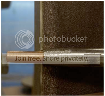

I didn't try the burner flare because it barely fits on the tube. I will go grind it out a bit so I can slide it and report back.

I think the idea of the mig tip being right at the mouth of the burner tube as I said, is right. Also as was pointed out by Salem Straub, the amount of flare past the tube end is critical.
no... grind down the outside of the nipple (tube) don't mess up a $10 flare. Remember there is little purchase for the set screw there as it is.

--- SO.... took my flare and smoothed out the weld inside and then took a couple thou of the burner tube (mostly because its a lot softer metal than the flare) so I could just slide it and voilà! well.. almost. It's progress though.
Still some tuning to do and if the mig tip should be right at the mouth of the burner tube then I will have to replace that nipple but it's promising.
I ended up still having it finicky to actually light and it will blow itself out after about 6psi but it's got a more of a roar and less sputtering.

Just thought I'd finish this off as I have it running pretty well now and am working to finish off my HT forge. Here's some videos of the burner running in the open and drying my first coat of Satanite.
The things that worked best for me are:
-The flare being about 3/4" to 1" extended beyond the end of the tube.
-the air intake covered a little with a piece of tape (I will drill and tap for a proper cover)
- AND this one.. Seemed to make quite a difference. It was in the instructions Kathryn Ellis sent me. You put the nipple in a drill and:
"You can grind a tapered transition between the burner orifice tube and the orifice tip to aid in laminar flow."
