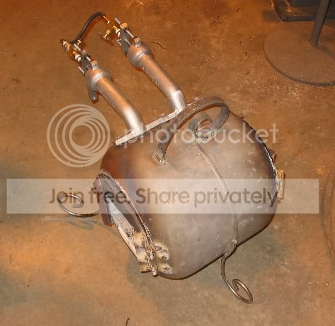

I just finished a LPG tank forge. It has 1" of 2400 deg. wool and 1" of 2700 deg. wool. There is about 3/16" of Satanite with 2 coats of ITC-100 on that. The bottom is 2.5" refractory brick with a piece of hard kiln shelf on top with ITC painted on it. The burners are 2 3/4" N.C. tool forge burners that have been modified. I flared the burners too 12 deg and made adjustable tops. The jet holes are #67 drill, thats .032".
I tried running it today and couldn't get my parts past orange even at around 18 psi. I am very disappointed with how it ran. I put a lot of work and study into it and now it doesnt seem to work right.
Does anyone have any suggestions about how to make it work better?

You using a blower? Sounds like it's choking out maybe...
I can't offer much help, but I think your forge itself is more than adequate unless you don't have the openings closed down enough (hard to tell from the pics); therefore, I'd suspect something not being right with the torches.
I have a somewhat similar sized forge with 2 burners, minus one inch of kaowool and the ITC-100 as compared to yours, which reaches welding heat pretty easily. My 'doors' are stacked hard firebricks, which do not have the best insulating properties.
I notice you have 2 lines run in how are they joined?Maybe another pic of that,probably more efficient to run one line in and manifold the burners together,you might be losing pressure the way their set up.Regards Butch
Its hard to tell from the pic, is the back of the forge insulated with wool? If not, insulate it.
Make a door out of steel with wool or stack some of the light weight insulated brick up in the front to close some of the opening off. You don't really need much more than maybe 4"x4" for an opening.
What kind of flame are you getting off the burners? The flame should have a nice blue cone in the center an inch or 2 long. I notice there are no choke plates on the burners to restrict some incoming air. When I built my burners, the flame kept trying to burn inside the burner tube instead of inside the forge and that was the problem, lack of a choke plate.
I would think that with 2 burners that size, you should have no problem reaching welding heat with much less pressure on the propane.

I think the problem is the curved burners, try some straight pipes. I believe the orifices should be centered as much as possible, gas shooting straight into the forge.
I cant seem to get the burner to hold a flame at all until the forge is hot. There is only one line in and it splits at the edge of the picture. I am getting a lot of flame out of the door when the forge is running.

That would lead me to believe it's the curved pipes. Mine did the same thing until the orifices were centered to make the gas shoot straight into the chamber. You must use the correct length and diameter of burners to make them work properly.

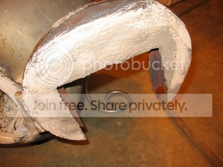

Here are more photos.
1. Complete forge

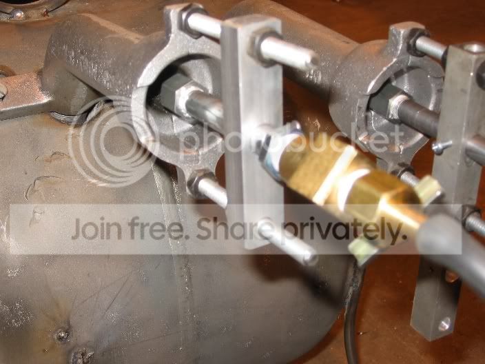

2. The jets
3. The door with Itc-100 and satanite
You can see in the photos that the jets will reduce the size of the incoming air port when they are moved forward.

I looks to me like the pipes for the gas are way to large and blocking the air flow.It is hard to diagnose just looking,you will have to keep fiddling with it:D

I'm bett'n on the curved tubes. Are those "modified" NC tubes from a blown or atmospheric (venturi type) setup? Seems to me there would be way to much turbulence with a bend like that. I have a side armed venturi burner and I cant even see the tip (tig tip) thru the air opening its so far in. I just got it running and moved it in and out till it ran good. Good luck.

NC burners are designed to have a manifold of square tubing that fit across the burner in the square notch, this blocks the right amount of air. And the orifice (jet) is threaded into the tubing, centered over the burner. Also my NC burners don't have flared ends.
Like said, try to get the burners to burn right outside the forge and I would set up the burners like designed by NC Tool. You got some tweakin to do :)

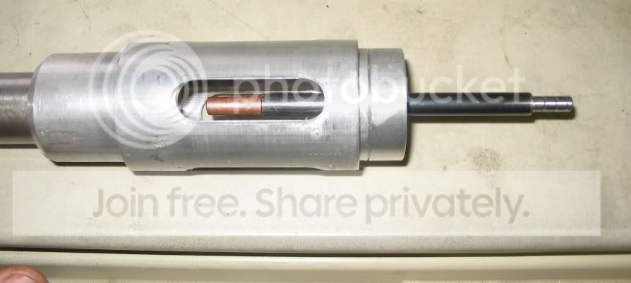

Thanks for all your help on this. I am working on building some new burners that should work better. I have built Reil EZ burners before and they worked great. I am working on something like the T-REX burner right now. I have all the tools to make it I just dont have more than a picture to work from. I have built the whole thing except the flair. The tube is just over 3/4" and there are 4 5/8" slots on the top. I presently have a .023 tweko tip in it. It will burn now at about 5 psi without a flair and with the choke turned down about 3/4 of the way.
