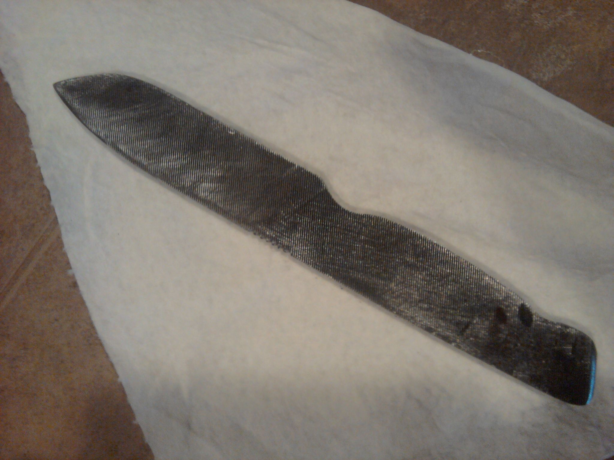

Hey Beckerheads! I could not wait for the Tweeners any longer, so I thought I would make my own from a file. I have put roughly 20 hours of hard work on this knife as it's not only my first knife ever to make, but I have only used another file to shape/grind it with. I did not have a cutter or grinder so I had to use the file to literally take both ends off of the file. I did use a Lansky Sharpening system to get the angle of the Scandi edge where I wanted, but 80% of the grind was from the file. I also but a design on the tang.
I have used three grits of sandpaper including 80, 600, then 2000. Not perfect but it works for me. I plan to heat treat, then put some scales on. I have not decided what kind yet. ANY SUGGESTIONS ??
1/8" thick
4" blade and about 8.5 inches OA
not 100% sure what the steel is but I think it's O1.
HOPE YOU ENJOY
It's rough shape:

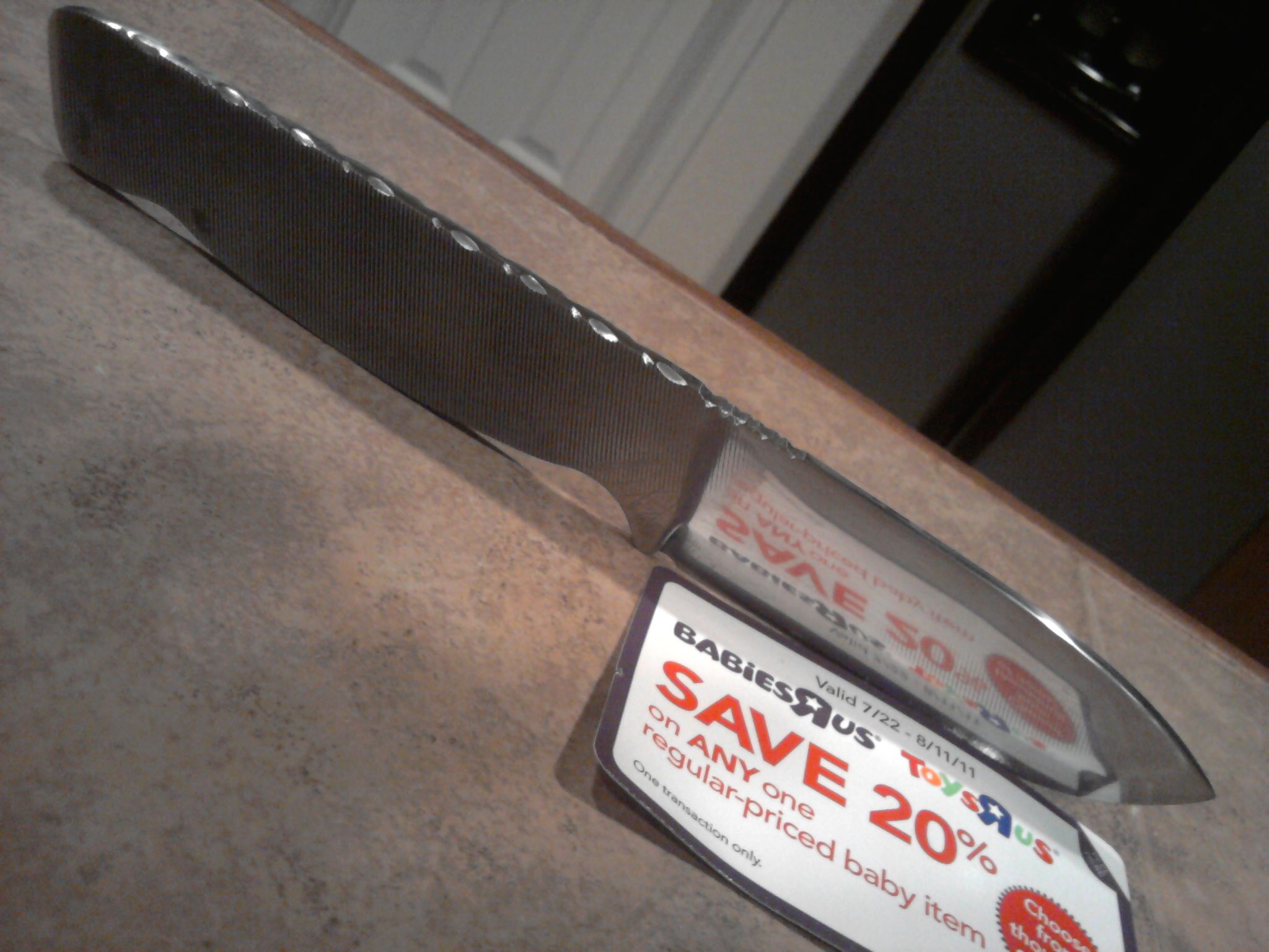

after a LOT if work and some sandpaper!

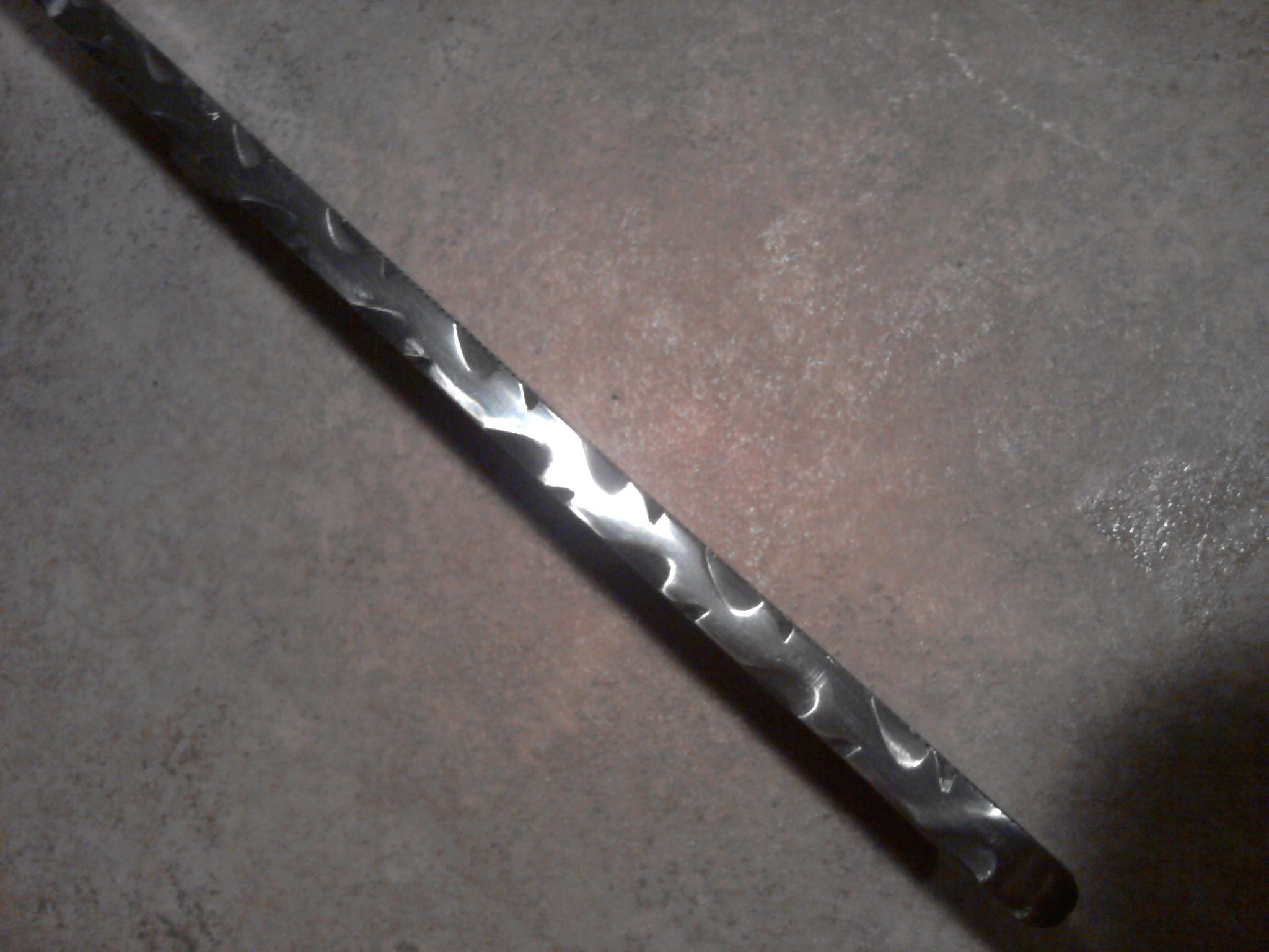

Putting some file work on the tang
That's a lot of work there man, nice job. Did you anneal it before you went at it with a file?
WHEREISMYCLOCK - Thank you!
tradewater - I annelled the file in my Bar-B-Q Pit before starting. Made it very soft!

I've been thinking about doing some file work on my BK9. It'll be my first attempt at doing that kind of thing on steel. If you wouldn't mind, could you take a pic or three of what kinds of files were used on which parts of the pattern? I'm thinking you just used a triangle and a rat tail. In any case, it looks awesome. Can't wait to see the finished product.

Thanks a lot! Below is a picture of the set of files I bought, but only two were used. One is semi-circle and the other is rectangular. The file work on the tang was done with a circular diamond rod not pictured and the squaure file. The semi-circular file was the work horse as it was able to take much more metal off and was used for the shaping and grinding.

That is RIDICULOUSLY awesome. Honestly one of the coolest things I have seen. Your hard work definitely shows. I would proudly carry and use that knife.

To anneal, I started a fire in my Bar-B-Q Pit and waited for a bed of coals. I spread the coals long enough to accomidate the entire length of the file. After placing the file on the coals, I put a lot more fuel on the fire and let it burn out on its own. I let the file completely cool on its own which in turn anneals the steel.
Once annealed, I used files to scracth and claw my way to a knife design.
