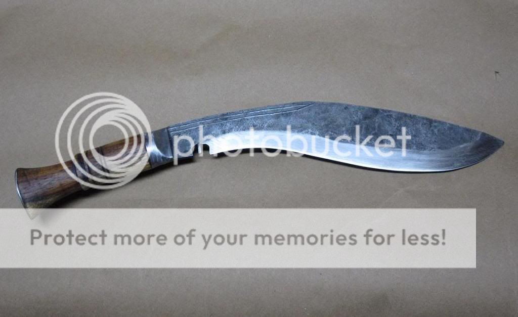

Patina was done by wrapping the blade with paper towels soaked in apple cider vinegar.
I will also mention that I did sharpen the knife and it is very sharp.
You grind the scale off first then do the vinegar thing?
That's how I did mine. Scrubbed the scale off with muriatic acid and little bit of gun blue/rust remover. Then gave it an acid wash and neutralized it with baking soda.
I didn't grind it off with any sort of power tools. Just vinegar, couple hours soak, and then some sand paper, and then more vinegar, etc.
In addition to flashbacks to the 60's the very word muriatic acid kind of skeers me some. Acid has to be a bad thing especially if your like me and don't know what the heck your doing.
Here is a shot of the other side. I polished some of the patina off on this side.

I just want to know more about how you got it look that way. Me wanna do the same on mines.
snow, feel free to email me with any specific questions. I'll be happy to help. Nothing I did was particularly difficult.
