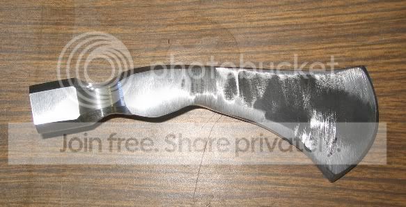

Hi, everyone this is my first post. I have been making knives for about 10 years as a hobby and have made to date about 75 blades. Both by forging and by stock removal.
I recently made a axe head out of a piece of car axle and was wondering if anyone knew what these axles are made of?
Photos? Tease us with a great first post and then leave us without a photo. Excrutiatingly painful!
You can go to photo bucket and sign up for a free photo posting site. Then link the url's to here and do it.
Here ya go!!
Depends on the manufacturer, could be 1050 / 4140 / etc there usually medium carbon stuff anyway

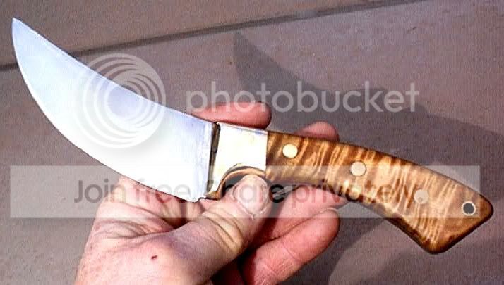

That trailing point really catches my eye! how'd ya finish that maple?

here are some tips with photo bucket . when your looking at the picture and want to show it from photo bucket just click the area below the picture that has IMG and then in your typing in here just press control and the letter v that pastes the url right into your text message way faster and no link. heres one i made the other day.
A few years back I saw a show on making a Kentucky long rifle. They had the most amazing maple stock. What you do is take nitric acid mixed 1 to 1 with water and dissolve a small quantity of iron shavings in it. Then you rub your handle wood with it. The more you put on the darker it gets. Takes some practice to get it right. Then they said to rub in several coats of linseed oil. I went for some polyurethane instead to make it a little tougher. However I think that the linseed oil looks better. The finish makes the wood appear almost transparent. It will probably work on other wood as well. If you want a less red look then don't put in the iron. The acid will still darken the wood but it wont be so red.
