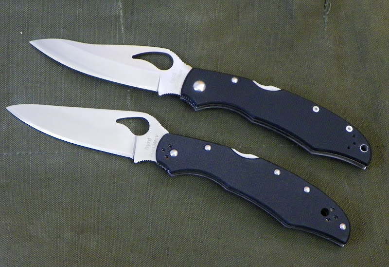

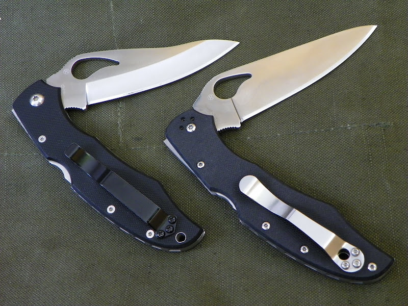

Comparison shots of Cara Cara G10 and Cara Cara2 G10

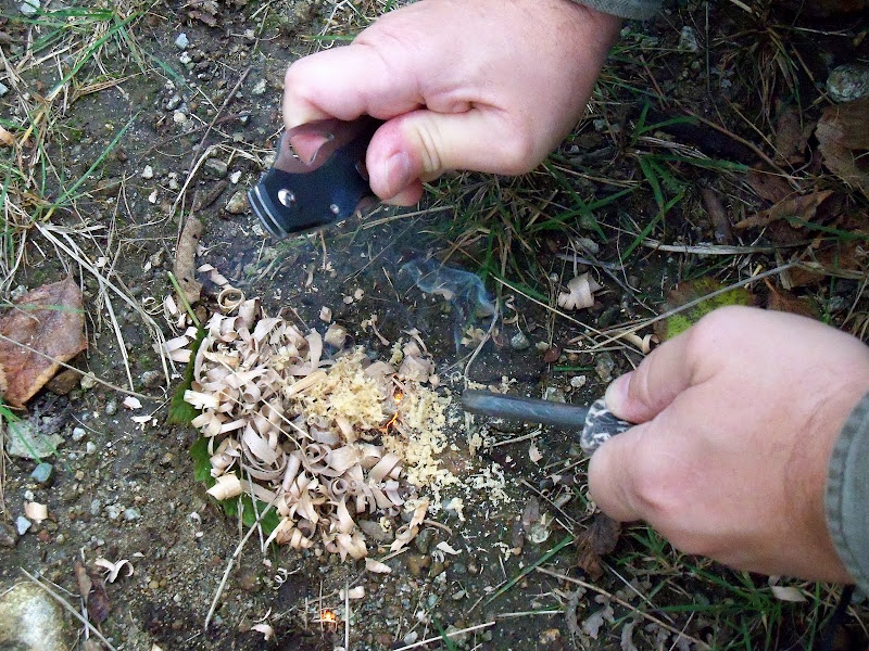

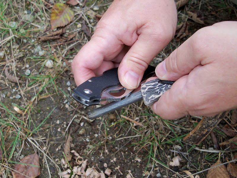

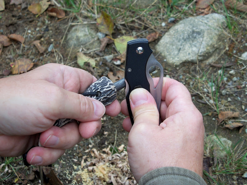

Variations for ferrocerium rod use with a Cara Cara...

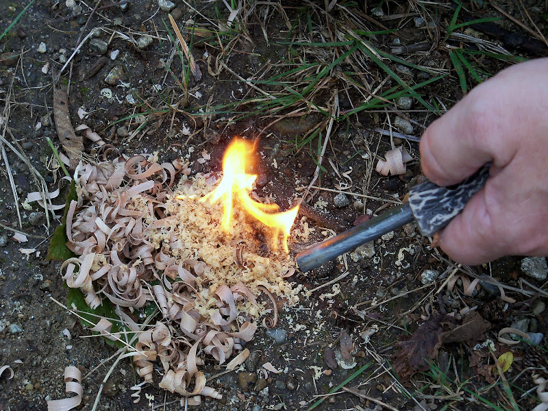

Fire!!

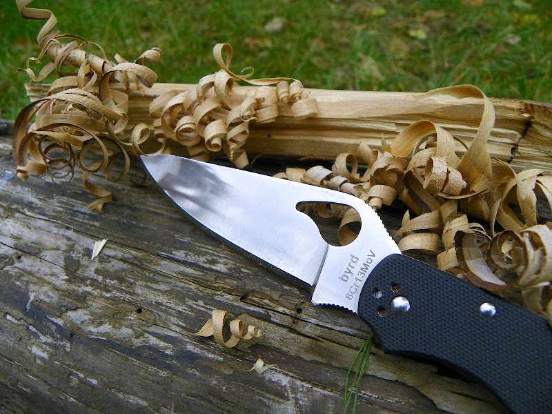

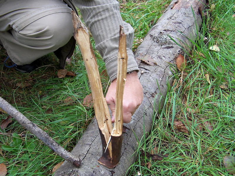

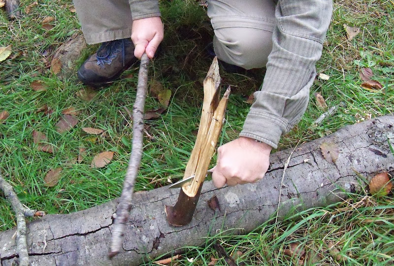

A few more action shots...

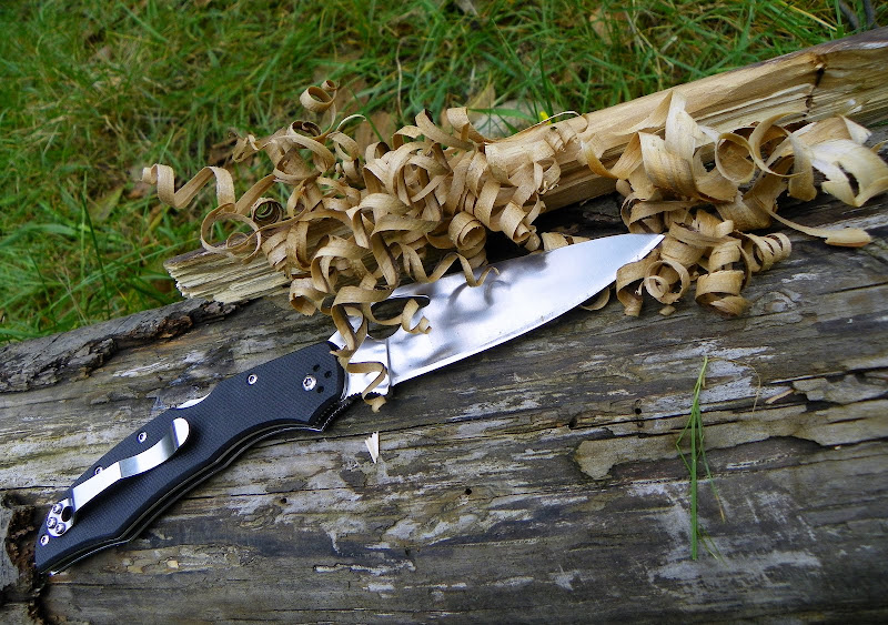

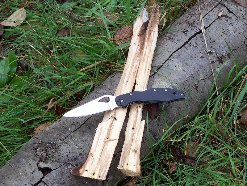

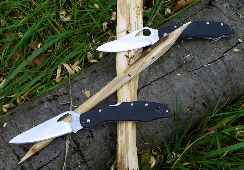

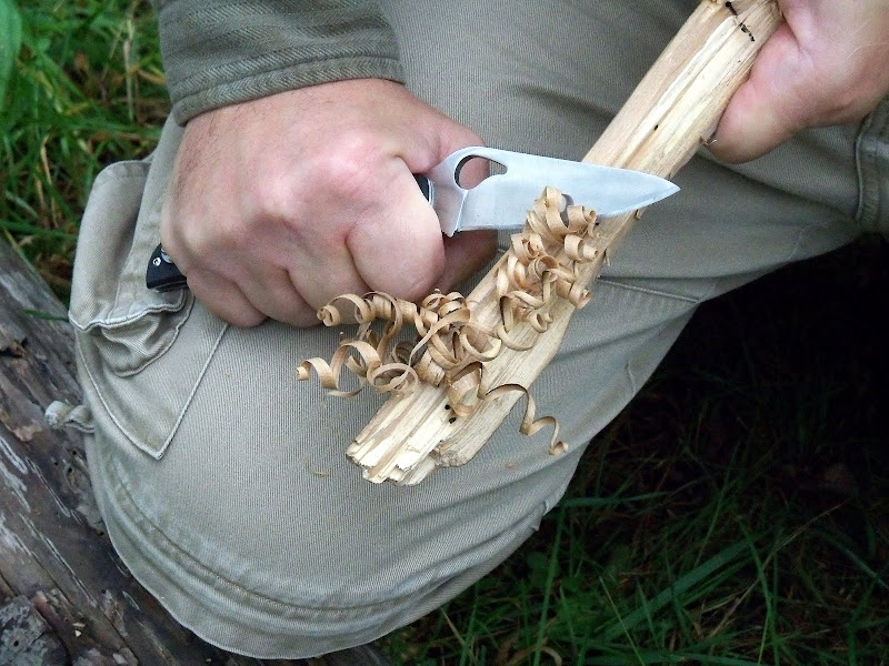

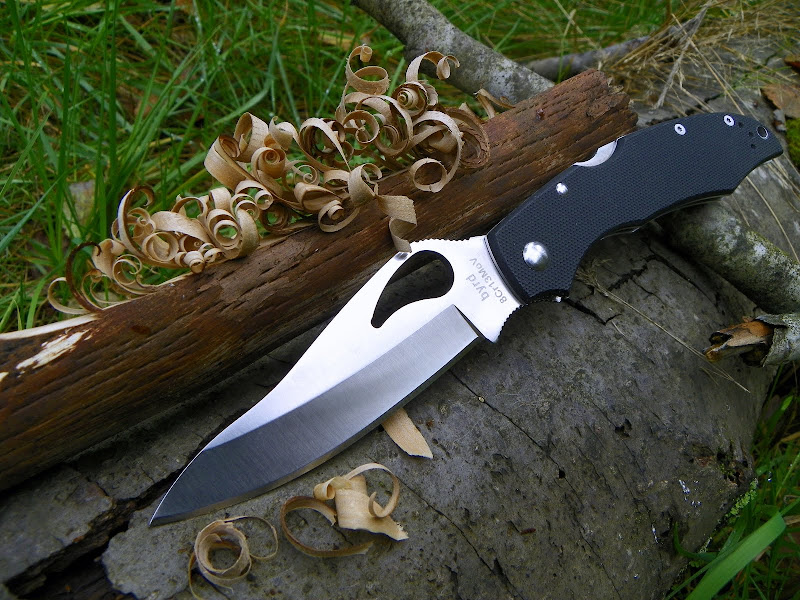

Finally, a little whittling/stake carving with the help of both versions... (each one at its own end of the stick... :) )

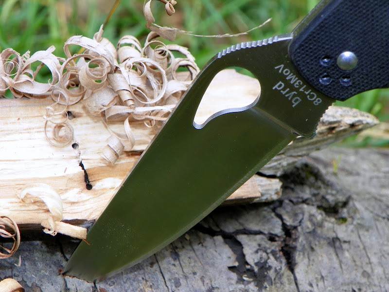

In my opinion, both models are good, strong folders, especially for the price. The major difference between them is the grind of the blades. The original model is hollow ground and the Cara Cara2 has a full flat grind. Blade steel is the same, they both slice and cut well. The blade of the newer model is about 3/16" shorter than the original for some reason. The little, threaded fastening holes for the pocket clip by the pivot screw, go through the panel and the liner as well, all the way. So, you can see the phosphor bronze washers underneath. I think that's not very good... for one thing, it's not very pleasing to look at and more importantly, dirt, dust and mud can get in the pivot point very easily. Personally, I like the original version more (mostly because of the looks, but that's a question of taste...).
