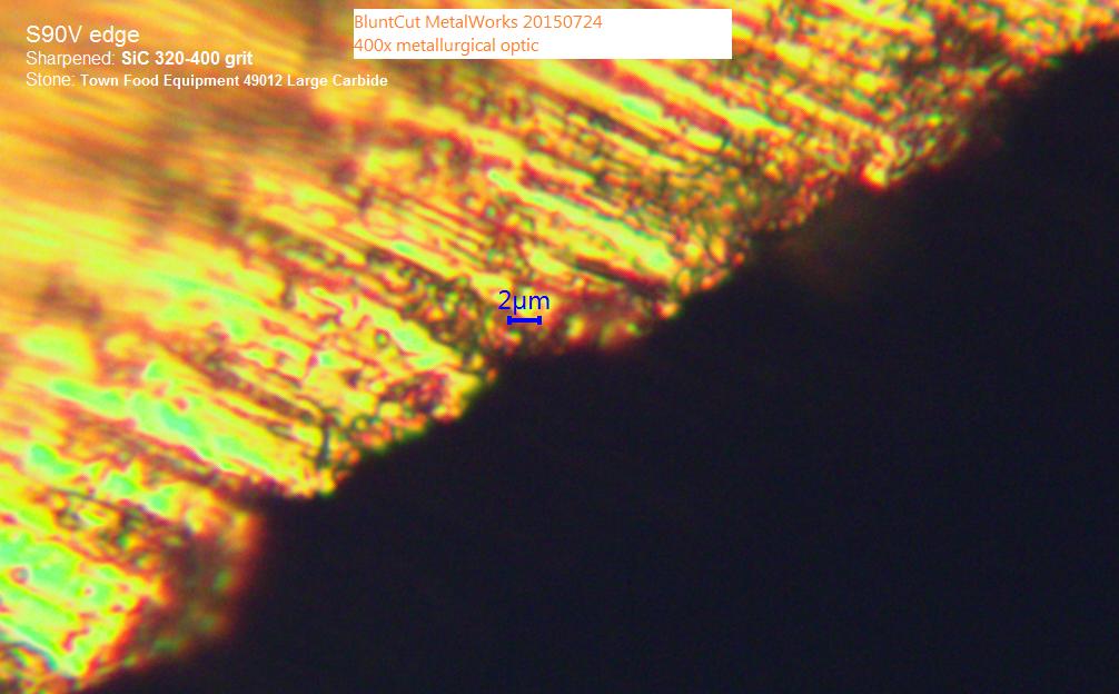

Here is my s90v tomato slicing edge, sharpened with 320-400 SiC stone.
Sharpened:
1. Flattened the apex (light reflected to naked eyes for entire edge)
2. Sharpen 15dps with 320-400 SiC stone, start with heavy pressure until almost apex. Gradually reducing pressure until apexed, whence pressure less than 0.5oz.
3. Use very light edge-leading strokes to deburred
Nital etched. I don't have picral or alike, nevertheless you can clearly see a lot of Vanadium Carbide. There are a few 2um VC along/near apex.
It's a bevel face view. Too hard to capture edge-on look due to shallow field of view.

Can you describe what the vanadium carbides look like in that photo?
If I'm seeing it correctly, the sharpening grooves are so deep relative to the size of the vanadium carbides that it wouldn't matter whether the SiC is harder or softer than the carbides because they are just being plowed out of the matrix.
When you make your final, very-light sharpening strokes, how long are the strokes? A leading edge stroke should cut off the old burr quickly, but then begin creating a new burr if you don't stop the stroke once the burr is gone.
Spherical & oblong bounded(ring around) objects (5um or less in dia size).

You are right, carbide shaping wasn't relevant when abrading depth/magnitude is much larger than carbide size.
I mostly use long strokes (lead & trail). With this 12" long stone, my strokes were extra long. 15dps edge leading at this low grit will hardly producing burr. Edge in pic was off the stone, i.e. no strop, no cut into material, etc... Note: my stone surface was rinse with water often when deburring. I've another of this stone but oil instead, quite messy & collecting dust now.

So the carbides are not sharp and make up a large amount of the cutting edge. Wouldn't that mean that sharpening them is pretty important for performance?
I think that's a good question, but it probably has the largest affect on large-carbide steels like D2 or 440C.
The typical apex of a sharp edge is 1 or 2 microns for most of us. The carbides in Sandvik's fine-carbide 13C27 tend to run 0.5 microns in size, so they probably don't need to be shaped, even if we could.

Ah so vanadium carbides are actually the size of the apex (roughly) and make little difference if they are shaped, depending on the distribution near the edge? I know chromium carbides don't matter much to me, because all of my stones will shape them, so even though the carbide is huge it will be worn down like the matrix.

Yes, it's matter a lot because edge quality/durability rely on matrix foundation. Carbide volume (proportionally) is a large liability for about 1.5*avg carbide size of edge thickness.
Most abrasive types will abrade matrix faster than carbide (stating the obvious). Even with diamond/cbn, surface carbides always be raise/stick-out of the surface at some level - amt (% of its dia) depend on carbide type & size. I won't go into excess matrix recess/abraded would undermine carbide footing/binding.
W/o an effective ability to shape carbide, mean abrading matrix + mostly-impacting carbides. If chunk of matrix is much bigger than carbide than carbide get ploughed along. When matrix is much thinner than carbide, impacted carbides will result with combination of [ status quo, displacement, tear out, loosen, etc. ]. For abrasive size range from very coarse down to 1/2 carbide diameter, (result) exposing carbides that still embeded to surface either 'status quo'/strong or compromised/weakened. Smaller grit than that will just polish (whatever reachable) sunk matrix surface.
Whereas abrasive can shape carbide will result with less 'compromised' exposing carbides. Notice the 'less' because impacts still taken place, they are: bounce off, push down, over-committed bite size, partial abrasion, etc..
Mitigating carbide durability issue is knowing what taken place in sharpening interaction between abrasive and matrix+carbide. Understand abrading mode [plow, cut, burnish, etc.] at when and why, so appropriate abrasive surface and forces (note: velocity is important). Aware that sharpening stroke where abrasive run into the edge/apex (edge leading), will has more apex plowing than edge trailing. If you want a very high edge durability -> when apex radius is about 1.5*avg carbide dia width, must avoid impacts that can compromise embedded surface carbides. By switch to fixed (plate or film) diamond/cbn with dia size smaller than 1/5 carbide dia. So abrasive size should stay ahead smaller than 1/5 of carbide size and apex radius.
You spend this careful sharpening progress to shape high alloy nano edge for long lasting(wear) low impact(no chop & soft landing cut) usages.
For rough usages - shape edge & surface features/irregulaties with lowest possible 'promised' carbides & features.

Crucible PM process create carbide around 2-5um in size. Avg size indeed around 2um but not uncommon to see aggregated (in micrograph) carbide 3-5um. CPM drop/particle size around 500um. Bohler Particle size around 250um and carbide still avg around 2um however a slight less variance toward 5um because of smaller particle size.
What is your blade hrc & edge geometry? Stropping (loose and partially embedded abrasives) topic is too complex to cover here. Black compound is SiC. oh heck, even with diamond most likely that your edge will be weaken by stropping.
Definitely most razor edge is by the matrix and some carbide peaks. Although, these protruding carbide and feature probably have receeded/eroded/weakened footing. Cardboard attr/variable has big impact on edge wear/tear. Perhaps, try slice a stack of thinner cardboard to see if dulling is about the same as thick cardboard.
