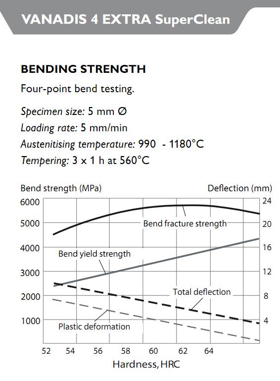

bending strength accounts for the vast majority of edge performance in cutting tasks - i.e. the
stiffer apex-material takes the keener edge. It is precisely for this reason that the finest-edged cutting tools are made from carbide hard-metals, not from steel at all!!! The finest steel apices on fine-grained steel are commonly ~0.5 um, while the working apex diameter of WC-Co and diamond and obsidian edges are commonly 0.05 - 0.005 um, some
10x - 100x sharper! The "pure" carbide materials can achieve this because of their strength (hardness). Increasing Rockwell hardness in steel brings it closer and closer to the performance of these materials. However, where these carbide hard-metals fail is macro-toughness - once you overcome that resistance to bending, they fracture readily, and the thinner the bevel-angle (geometry) BEHIND the apex, the weaker (cubic) the material is with regard to resisting lateral stress.

I really appreciate what Luong does because he is pushing for the HIGHEST possible Rc hardness, to bring his blades as close to the strength of carbide hard-metals as he can, but while simultaneously demanding that they endure severe impact force and edge-steering.
The steel industry has been working toward more and more carbide-rich steel in order to improve tool-performance while trying to maintain the toughness that steel is known for. If they didn't care about toughness, they wouldn't be working on refining carbides. While on the other end, hard-metals are almost entirely carbide but the industry is working on making them tougher to be more like steel without sacrificing the strength that carbide is known for
