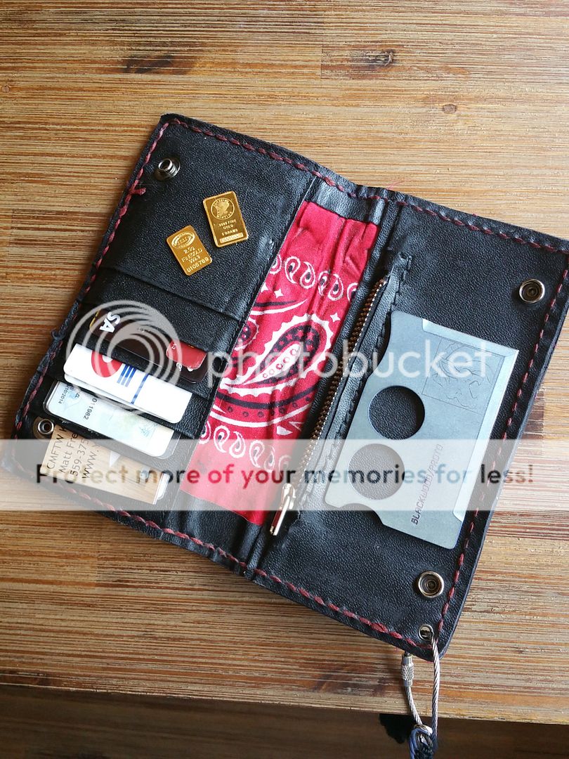

This guy is ALWAYS in my wallet.
Nice "emergency/bug out" gold rations you got there Matt. In handy mini wallet size. ;):thumbup:
I use to keep a full British sovereign (my favorite gold denomination) in my wallet "just in case".
