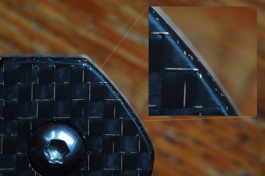

Well, seeing is believing so I grabbed a macro lens and took a quick and dirty closeup for you (natural light, freehand, so it's not perfect):
The stuff is pretty nasty looking at this magnification, but it's gorgeous in person. The surface on top of the weave is perfectly smooth, and you can see where Barry shaped the edges that the copper wire doesn't protude at all.
Thanks. That's probably why Rycen put the condition in his statement that LSCF has to be finished properly.
I always thought CF would make a knife considerably more expensive. But after checking out the Sage and Chap (and their more than reasonable prices) , I couldn't be more wrong.
As someone that has used LSCF extensively, as well as regular carbon fiber, the material has to be sanded with several different grits of sand paper to get rid of the tips of the copper. And I've gotten my share of nasty slivers of copper in my fingers. They hurt. Alot!. I've gotten slivers of regular c/f, too. One of these days, I gotta retire:rolleyes:

I've fondled every millimeter of this one and there are no copper pokey bits. It's smooth and perfect, as far as I can tell. That may just be Barry H. doing a great job of finishing it, but thought I'd give you another data point:
I do like the appearance of the LSCF, it gives it a warmer color, but then again I really like normal CF also.
That looks clean. I like it.
