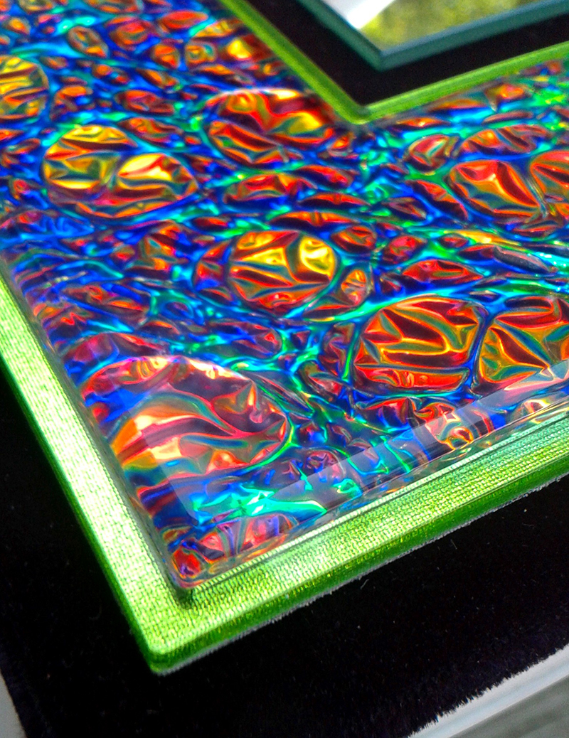

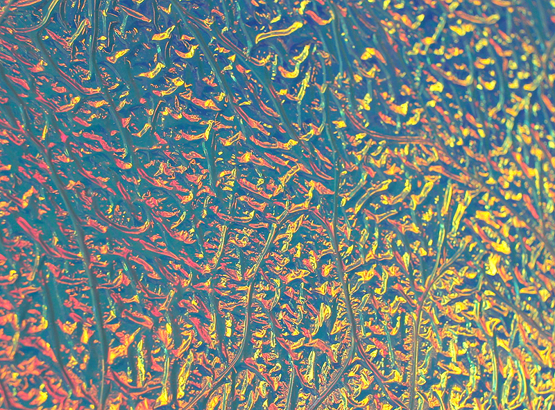

Yeah, well you just described my other product - Dichrolam. Used to make it in glass, but now acrylic and epoxy resins. Acrylic, because it buffs to high gloss, and epoxy for lower expansion / contraction. This stuff will be in the sample kits as well. Looks a bit like Timascus (obviously) but is less expensive and machines with a "lens" effect when polished with roundovers. Left edge of this photo is polished with a 1/8" radius "teardrop" edge. This is a photo of "White Burl", a little different than the "Fire Burl" in my opening post. I think the real potential is in the figured CF material. However, you should see my Dichrolam "Burls" inlayed into the figured CF. Might be a match made in heaven for you guys. Thats were my epoxy version comes in - it can be inlayed right into the CF.
Red Burl inlays cast into the figured (not solid) curly CF.
I think those would make killer backspacer accent pieces for otherwise minimalist designs. As pocket clips I'd be a little concerned about the flexibility of the acrylic. No one makes pocket clips out of acrylic as far as I'm aware, but carbon fiber clips aren't super uncommon.

OK, y'all have inspired me. I decided to inlay some of my new dichroic burls into the Figured CF stock for the samples I'm sending, and tried a better method of patterning the White Burl, as it looks a little like the rainbow colors you get from heated metal oxide layers. So I combined my method to make Gold Burl into the turquoise / magenta patterning of White Burl and came up with Titanium Burl. You wait til you see this.
