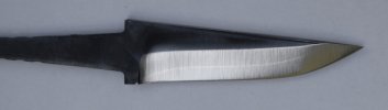

Lauri utilizes my finding in his double hardened blades (Lauri PT blades). At first, the blade is hardened and spring tempered, and after that, the cutting edge is rehardened. The blade won’t break due to relatively soft (50 HRC) spine, but also, due to double hardened edge it has exceptional fine grain size, and for that reason, it resists chipping despite of 63 HRC hardness. Here is a picture of my favorite model of Lauri’s double hardened blades. The faint line in the middle of the bevel is the line of the second hardening. It becomes visible during grinding because hardness difference.

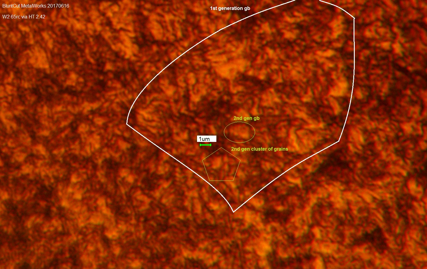

per green-highlighted line: there are quite a bit of published research & lits on using particle (precip cementite in this case) to refine grain. Micro-alloy and other MC particles can help achieve grain dia to certain size, further refinement - one would need transient particles to nucleate prev-aust-grain. Your Lauri's example (btw - very nice blade), spring tempered = well distributed precip cementites which just large enough dia not to dissolve on 2nd aust, where they are pinning new grain (nucleation points/interfaces).

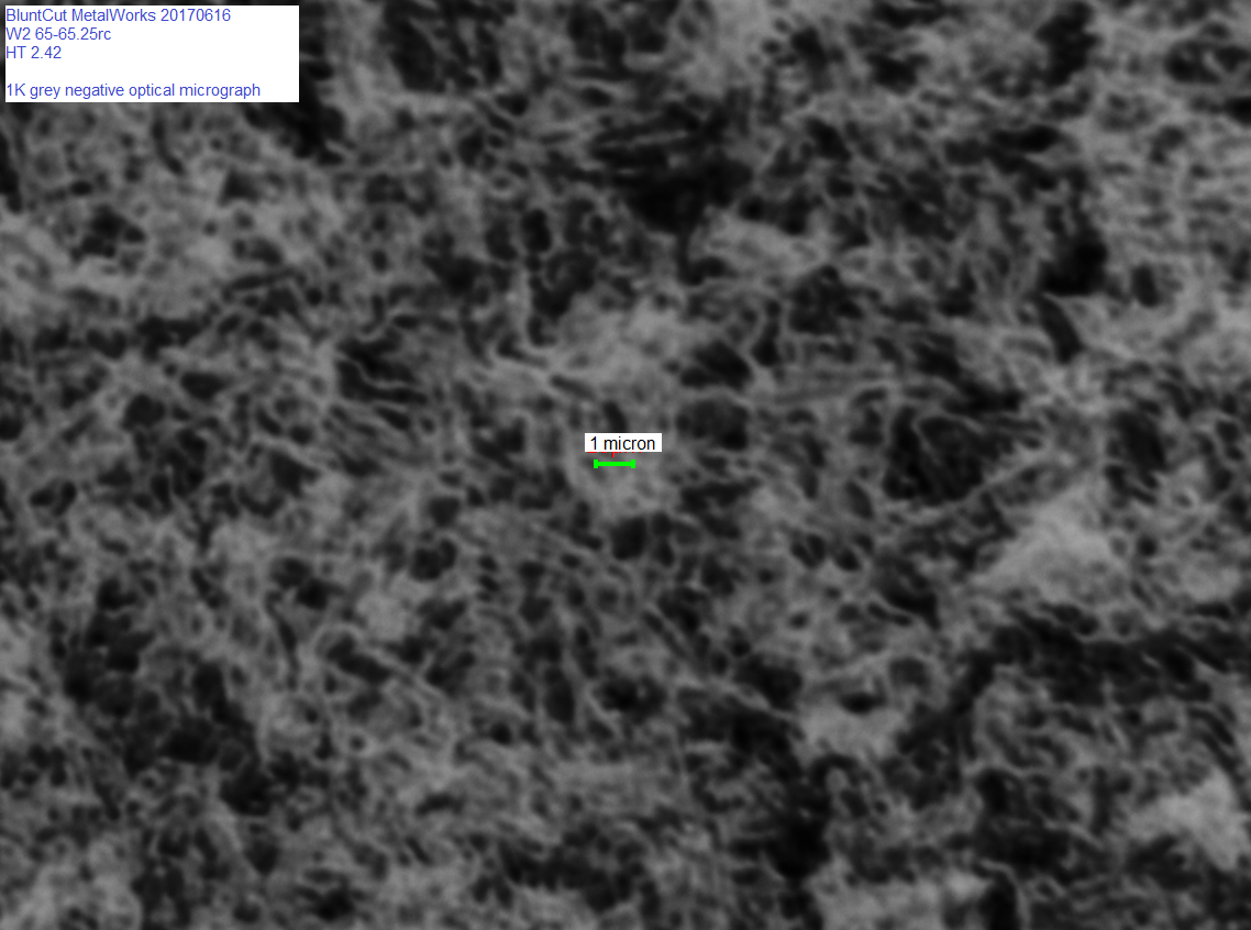

Here is my light/optical micrograph (1K negative) of W2 microstructure after 1 hardening. I also optimized on gb cleanliness(minimize precip/agg), thereby getting higher cohesion. 99% of my blade in low/no cr% steels have working hardness at 64+rc.

About Lauri’s double hardening process. He uses 80CrV2 steel, which contain only 0.8% carbon. Thus, it is necessary to dissolve all cementite-carbides to attain high hardness, but the 80CrV2 steel contains about 0.2% vanadinium which binds 0.05% carbon into vanadinium carbides. The vanadinium carbides do not dissolve during hardening, they are very small and thus their number are large; therefore, they effectively prevent grain growth. The first hardening (spring tempering) is made in a furnace, and the second hardening i.e. the edge hardening is made by electricity (induction current). The induction heating lasts only a few seconds at about 900 C. Lauri's process control includes hardness measurement, grain size measurement of fracture surface, and torture test of the edge.

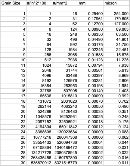

Is there a chart that will convert 1 to 10 fracture grain size to microns? an example, properly HT'd O1 will have a grain size of 9.5, what would that be in microns? ref is http://cintool.com/catalog/Oil_Hardening/O1.pdf

Just an fyi, fracture grain size and astm grain size, like blunt cut listed above, are not the same. Sheppard fracture grain size scale stops at 10, and is more qualitative, where as astm is definitely quantitative. Also, there is no guarantee that what you're seeing on fracture surfaces are actually the grains. Not all fractures follow grain boundaries.

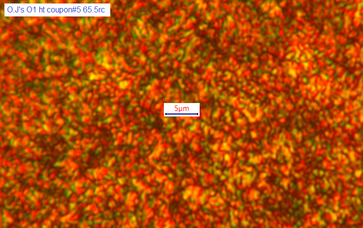

Yes, the grain size seems to be around 5 micron, but it is difficult to see because martensite substructures are also visible.me2 - thanks for clarified the different between terms.
Twindog - thanks for sharing and plus you are more than just a steel junky... quite informed on metallurgy and accurate failure analysis on your new 5160 bowie poor performance due to coarse grain microstructure. I agree with your assessment however having difficult time to envision a ht recipe to produces a chippy 5160 at hardness below 60rc. Beside coarse grain, it probably has a major case of cementite precipitated in grain boundaries.
I got permission from O.J. to post micrograph of his O1 ht coupon #5. Just look carefully to see gb - those continuous path formed circumference with diameter between 4-6um.
