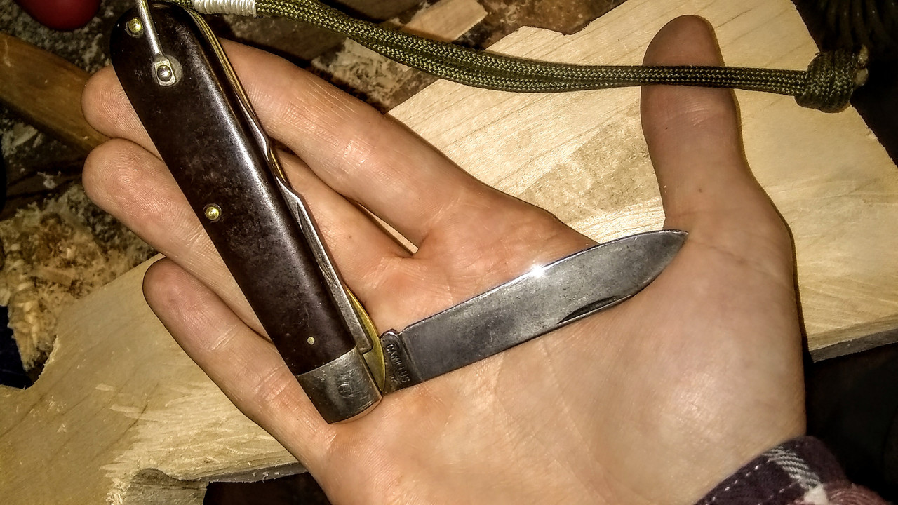

A well loved patina covered carbon steel blade just really gets me, I'm fine with using stainless steel but it doesn't excite me as much as Carbon does.
There's nothing like the glint of a fresh shiny edge on a dark patina covered carbon steel blade.
