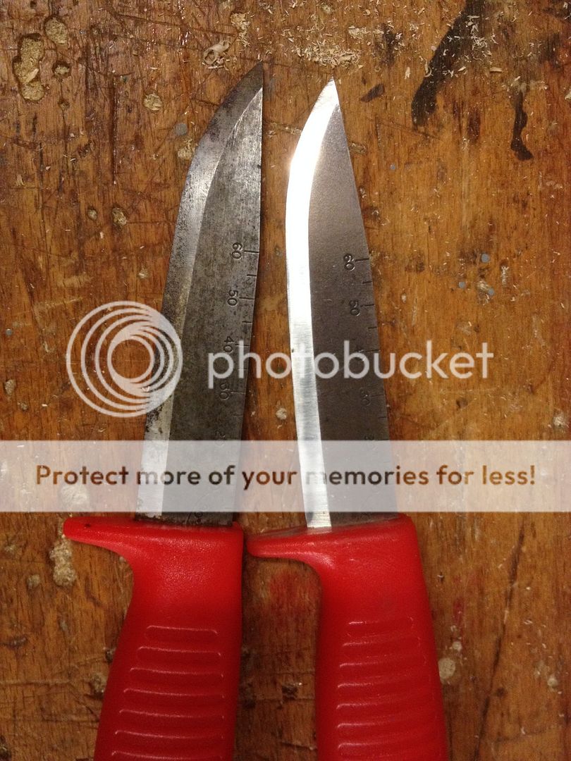

Will corrosion or patina affect cutting performance? Yes, and No I think. "Yes" because if the actual cutting edge corrodes then you'll lose a bit of the edge, and also because a corroded surfaces is not as smooth as a clean one. "No" because in the real world if the corrosion is just what we'd call "patina" then there's no appreciable difference in smoothness, and the it will be removed from the edge as part of normal sharpening. Just for fun here's a picture of two identical Frosts (Mora's food prep brand), bought the same time a few years ago. Guess which one lives on board the boat, and which one is used at home.
