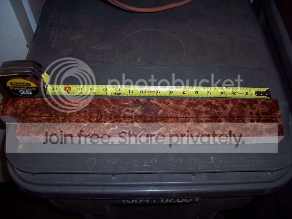

Long ago I found a piece of what I presume to be redwood or cedar burl that I sliced up (in my own amateurish way) and sent off for stabilization. When it came back I sanded off the external gunk and was disappointed by how dead the pieces looked. Essentially, I threw them in the drawer and haven't seen them or done anything with them since.
Several other pieces of wood that I sent out for stabilization also came back looking less lively than I had hoped when sending them off.

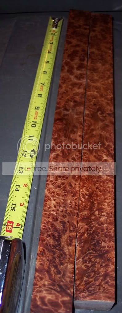

Today I learned something about stabilized wood. I received a piece of stabilized buckeye burl that looks like it had a lot of unrealized potential. I decided to wipe it down with Howard Butcher Block Conditioner (a mix of mineral oils and natural waxes) and the contrast, figure and chatoyance all jumped off the wood immediately. I was so excited I gave the same treatment to all the other pieces of stabilized wood I have and was amazed at even some of the early redwood/cedar pieces. All the life I'd hoped to see is now visible.
So, for those who are collecting stabilized wood, as I am, be sure to give them a wipe with some moisturizer to reveal the beauty underneath. It will really help you see what the final handle will be able to show.
- Greg

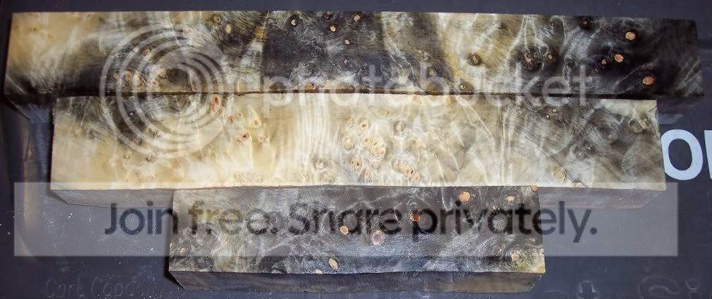

Sometimes I do that for pics to get an idea what I got. Sand one side to a high grit (220 cuz I hate sanding), and use danish or minwax antique to temporarily pop the grain. You can see from the pic the other sides look chalky and white still. It lasts a little longer than water for this purpose, bu like Stacy said its not "permanent". These will hopefully be pointy sticks someday soon....

Will the CA treatment work on stabilized wood? I though stabilization would prevent the wood from absorbing anything? I know that wax will temporarily brighten up stabilized wood, but assumed it was merely brightening up the resin itself and not the wood?
I was not aware that Bruce left much CA on the surface after rubbing the debonder dissolved mix into the wood and sanding it smooth.
The CA method works well with stabilized wood. It is a common misunderstanding that stabilized wood will not allow any penetration. It will not swell or shrink, but if there is a grain or pores, water or other things can fill those voids. One test for determining stabilized wood is to sand the end grain and then soak it in water for a few minutes. Set it end grain down on a paper towel. Pick it up after a few minutes and wipe it off. If it is stabilized, all the water should have drained out, if the end looks wet, the wood is not stabilized, or poorly stabilized. Some do this test by weighing the dry, vs wet, vs drained wood. There will be a small difference between dry and drained on stabilized wood, but there will be little difference between wet and drained on non-stabilized.
