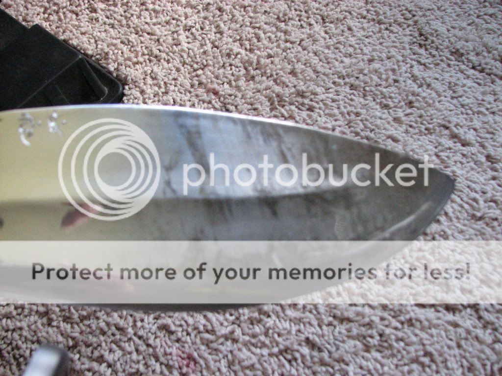

ok here is a photo before I started polishing.

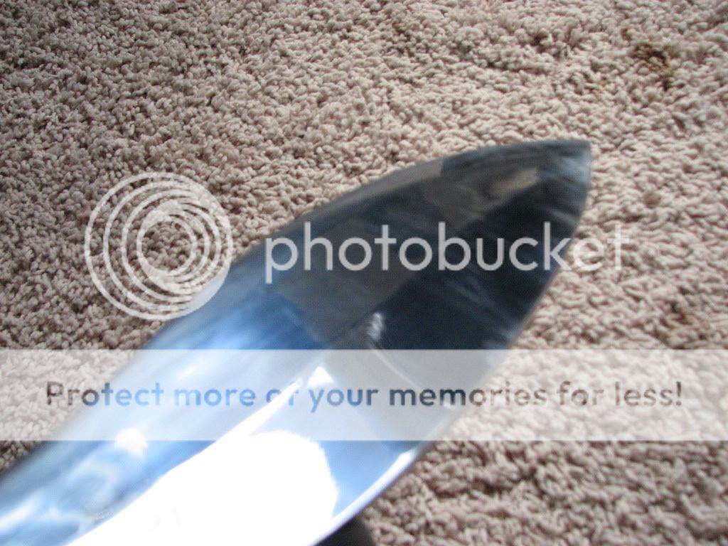

here's one about 20 seconds of polishing..

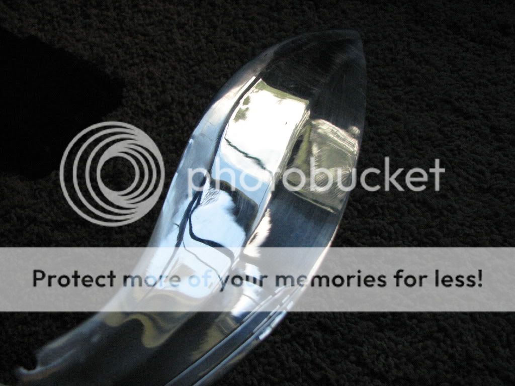

and another (decent camera I just don't know how to use well)
It helped some with the little efforts I put into polishing with wheel and compound.. But all my knives are users so whats the point?? other then care, so with that said.. I may from time to time after they're really worked give them a once over, but til then its just basic lube and protect..
