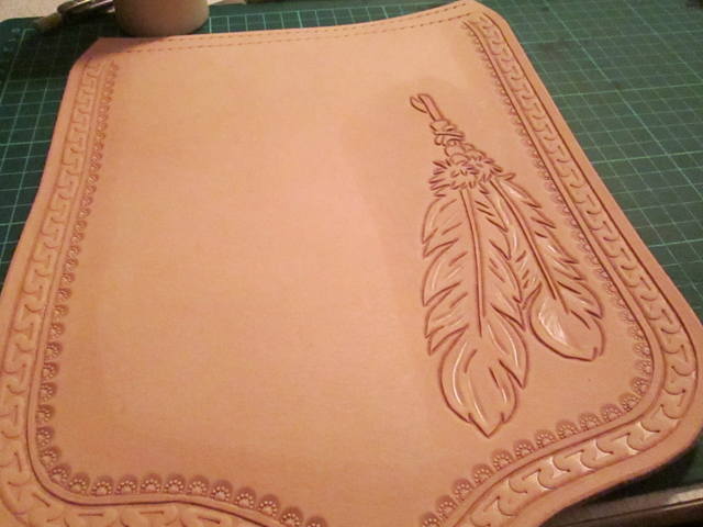

Been asked a couple of three times for this tutorial over the years. Finally got the pics done to write er up.

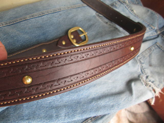

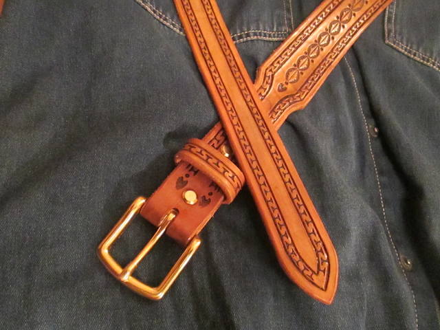

The Carlos Border, Running W or Meander Stamp is all basically the same thing. Different names I guess. Its used often in western applications. I will use it on sheaths, holsters, rifle scabbards, martingales, belts, leggings etc. You can get several different stamps. The concepts I will show you here work on the other stamps too, really its just figuring out the spacing.
I almost always use the small Carlos border stamp. It just seems to fit my projects. The only time I will use the large is when I'm doing a rifle scabbard or a martingale.
