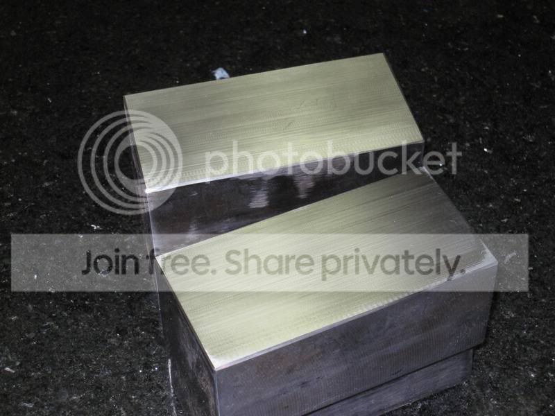

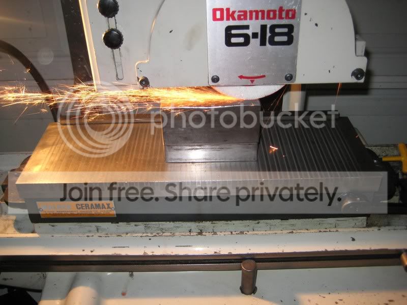

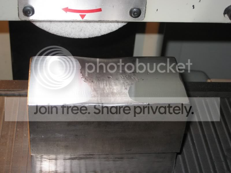

Cool picture flattening an Sahinler power hammer die on my surface grinder. The dies are S7, and they were badly wallowed:
Before/during:
After:
