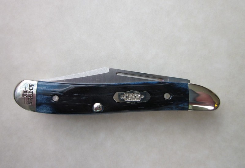

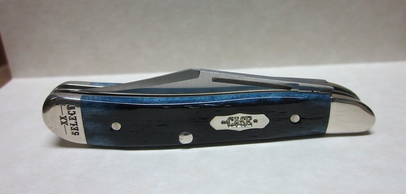

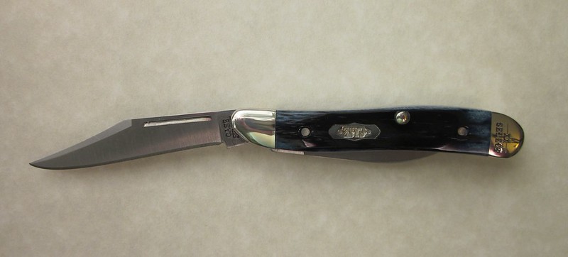

Sometimes, you'll find as-ground blades on knives not in the Workman line, like this Case Select Peanut:

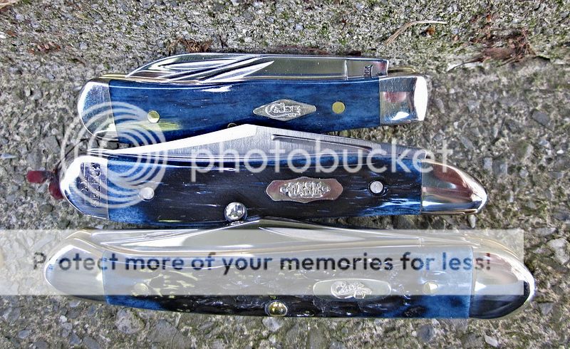

Here's an over-done image that exaggerates everything(!), including polished vs. as-ground blades (the Peanut's in the middle):
chromyasground.jpg~original
I prefer satin to the (over)polished look and feel of most Case blades, so this As-Ground Peanut works out well for me. :)

Sweet looking Peanut, Sarah. I don't think I've seen that one before.
they should do more in this finish. looks much better, IMO. and in my experience, when a satin type finish begins to patina, like CV steel inevitably will, it looks nice. Whereas the first patina on polished blades always just looks kind of dirty and greasy to my eyes.
Thanks! I bought it for the blue, as any normal person would; the as-ground blades were a pleasant surprise. The as-ground factor almost makes up for the the blades' being stainless instead of CV.
Almost. ;)
