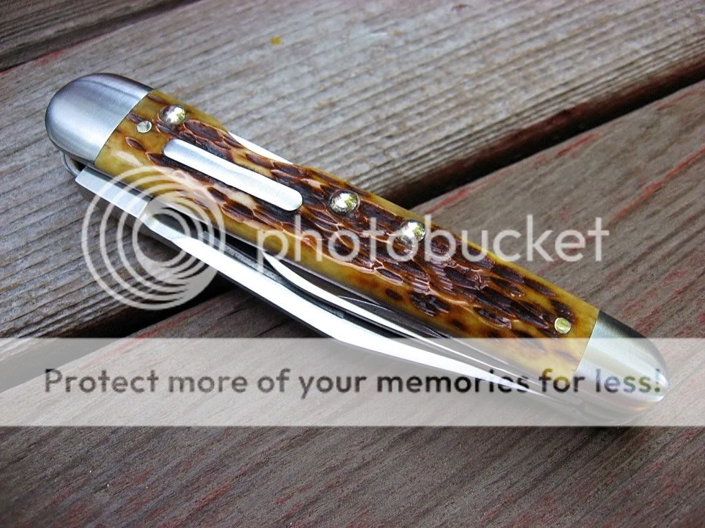

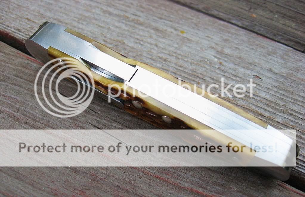

As I understand it, Tony provides Case with two handmade prototypes for each annual collaboration knife; one complete, and one take-down version. The latter is disassembled and the parts are scanned and duplicated at high tolerance on a wire EDM cutter, after which they're hand assembled by a team of three people under Tony's guidance. These "mid-tech" knives easily rival every new or old traditional production knife in my experience in terms of F&F, and feature small but important details like mill-relieved stainless liners and bronze pivot bushings that are usually only available on the finer handmade traditional knives.
I think pictures often speak louder than words, so here're my two faves; the '05 lockback sleeveboard whittler (certainly one of the most demanding production knives ever made), and the '09 Norfolk Wharncliffe:

Excellent pics, Rick!
Is the tang on the master blade as "fat" as it looks in the photos? I like it!

Thanks, Rick. Yeah - the master blade and lock bar on the lockback whittler are pert near 1/4" thick, giving it a bank vault-solid lockup, while the blade is ground thin, and very sharp.
