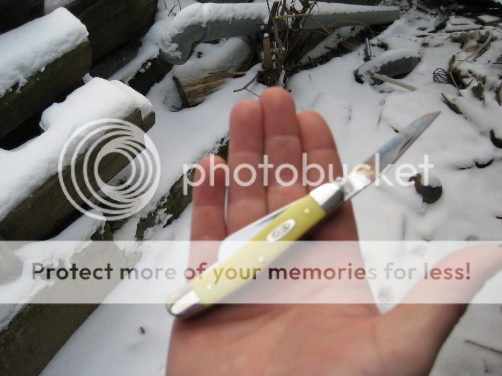

This is the patina, the knife got with food prep. Like apples, bread and meat/sausages ;)
I just wanted to show off.
Kind regards

anyways this is what CV can look like if let go and used on food (lots of Fruits and Veggies) i use mine with food alot, so results may vary, and actually i ended up steel wooling off some of the patina a while back, though it's about to this point again...
gene
