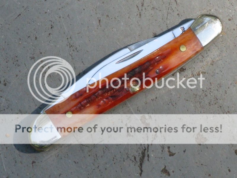

Okay, so the process is on. The knife is simmering in the dye on the stovetop as I type.
Here are the before pictures.
Updates to follow.

Too much dark brown RIT in the first attempt. I am starting again, this time with only sunshine orange dye.
But I may have passed a point of no return on having orange as the base color.
Be sure to check progress regularly. Maybe keep a mug of clean hot water for a quick rinse on hand? (hello microwave)
Good luck!
Very interested to see results. Case should have that canyon bone darker and a little more burnt to start with. Best of luck!

Will, the action seems just fine. It was a bit stiff in the joints after the initial flush, but a short soak in mineral oil then some working of the blades open and close, and it is just like new.
Off to shoot some after pictures now.
Okay, picture taking was a bit frustrating because I don't have the same light. My before shots were taken at a different time of day than I am working with now. Nonetheless, I have tried to capture a fair comparison.
I just realized that I oriented the knife differently for the bottom shot, so the thicker bone of the pen blade side is on the right in the before shot and on the left in the after shot. Sorry about that.
The wharncliffe blade side was a bit darker than the pen blade side to begin with, and that remains the case after the dye job.
Wharncliffe side before:
Wharncliffe side after:
Pen side before:
Pen side after:
Bottom before:
Bottom after:
My thanks to Flying Guillotine and jamesbeat for their instruction and encouragement on the process.
SubSpace, I used liquid RIT dye: Sunshine Orange and Dark Brown.
For my first attempt (which was too brown for what I wanted) I used 3 tablespoons of the Sunshine Orange and 1 tablespoon of the Dark Brown in about 2 cups of water. After 10 minutes in that dye mix I decided to start over. I rinsed the knife and began the whole process again, this time with 3 tablespoons of Sunshine Orange alone.
_______________
Edited to say what I should have initially. The second dye, with just the orange, I let go on for about half an hour. I checked it periodically, following FG's advice by dipping it in similarly heated clear water. Once I realized the color was not going to change much more, I turned off the heat and began the cooling process.
