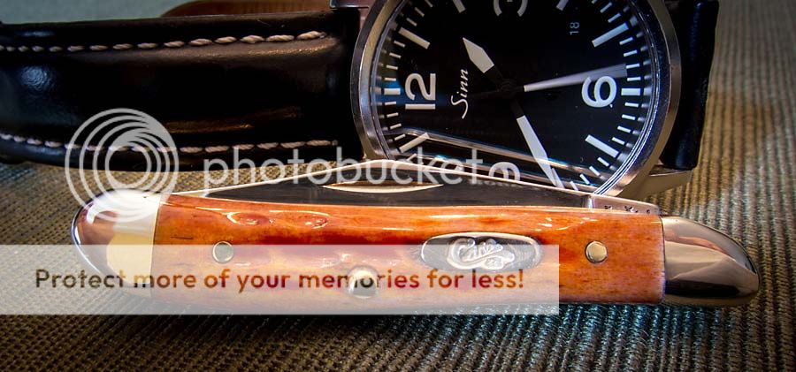

Well, I have done this to several of the Case Peanut knives with success, your mileage may vary so take things slow and only use hand files if you attempt to do this and remember, it'll probably void a warranty upon doing so, but then, it's not a high priced knife so...
The Case Peanuts are great little knives, very very handy little rascals to be sure! I made a grievous mistake of selling off a Damascus bladed one a few years ago, didn't really understand just what I had, things can go like that :) Recently had a CV model, and also what's called a Big Nut model, has 4 blades and a pair of scissors, nice but a bit thick for watch pocket carry, I had sold the CV model and missed it, so just ordered a stainless model, not a big patina fan, it arrived today and as with all that I've handled before, this one also has both blades with a marked angle when opened, meaning they are not lined up straight with the spine of the handle, at least in my eyes. NOW I know they probably designed this angle in on purpose, fine, but for me, not so fine and I'm too much of an OCD kinda guy that I couldn't live with that, so I take a jeweler's file and carefully...very carefully, file down the back springs so the blades will fall open a little wider, shown below is the knife, next to my most favourite watch, and then some before and after photos of the blade positions.
Take note that while the file will probably not fill the full width of the spring, you'll slide from side to side to get all of it, but sometimes one of the very side of the spring will have a raised ridge that I usually will try to file off with the blade partially open so the spring is up and away from the back of the frame, you may nick the bolsters but just be careful and you'll be fine, worse case, sand down any nicks you may put in the bolsters later on.
Here's the beauty;

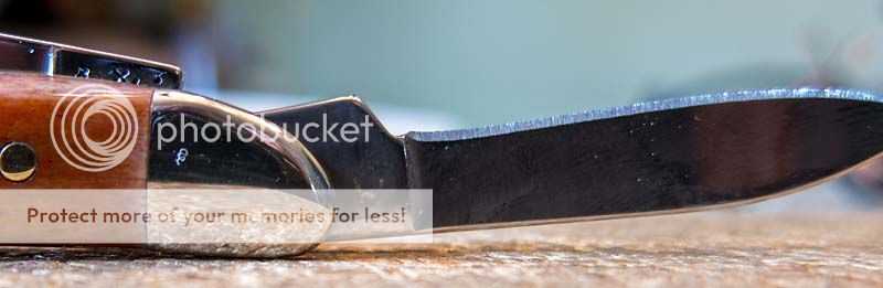

Here you can see that the back spring ends have an angle to them, you'll be just knocking down the peaks on these to allow the blades to fall back more.
Main clip blade before filing
Maine clip blade after filing, you can see it sets closer to the deck now;
Pen blade before filing
Pen blade after filing
Now when opened, both blades, again to me, look better, straighter and that helps to keep G2 happy ;)
Again a word of warning, do this little by little, because you can't add metal back very easily and do it by hand, no power tools on this operation!

I just finished doing the clip blade on my Peanut. I think the spring may've dropped a little bit, when the blade is open; but, like you, I didn't take a hard look at it before I started. As opposed to filing the end of the spring, I instead filed the contact face on the blade itself. I used a wine cork, pinched between the blade and handle, to hold the blade about 1/3 open, allowing somewhat easier access to the flat contact face on the rear of the blade. Used a DMT Fine 'credit card' hone to file it down (care needs to be exercised to minimize filing marks on the bolsters, via the diamond hone's edge).
I'm still liking this method. The slight (possible) drop of the spring is a very small price to pay, for straightening the lines overall, from the handle along the spine of the blade. As a bonus, the flatter contact face at the rear of the blade seems to make much more flush contact with the spring end. I've never really liked the look of the tumbled (therefore rounded) corners on the contact face at the blade's rear, so that looks better now, butted up against the flat end of the spring.
